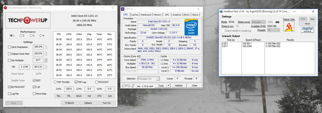

You can almost certainly run the Xeon with all cores at it's turbo multiplier. I have a Z97 board and a 1231-V3 runs all cores at 3.8 under a heavy load with no problems.
It's basically a 4770 without the igp.
A 1271-V3 will likely run at 4.0 with no problem.

Unless there is some magic I don't know about this is a common misconception on how turbo boost works. The 3.8 turbo boost frequency is only for ONE core. The max all cores can run at is 3.6 with the 1231.
EDIT: After a bit of reading it looks like some motherboards can bypass turbo boost and force all 4 cores to 3.8. Guess I will have to look into this with my MB...

Yes I posted about it in another thread, with screenshots. Someone on Youtube was running a 4790S, I think, with all cores at the turbo multi. It was happily running them all at 4.0 with no problem.
My Xeon with all cores staying at 3.8 during IBT:

I believe the cooler is TS15A in the above screenshot. The Xeon stayed pretty cool.
EDIT: it was a 212EVO, I found the thread:
http://forums.anandtech.com/showthread.php?t=2447253
The ASUS Z97-A board has no problems. It runs the Xeon at 3.8 under full load. Just went to manual, sync all cores, set to 38. Reboot. And Bob's your uncle.
So far, so good.
Power set to balanced in Win10. Idles nice and cool. All four cores go to 3.8 when called.

Actually you guys are both right, with latest bios all of the motherboards will lock it at 3.6 turbo, thats why you have to "retro" the bios to ealier bios which will let you max out all the cores at 3.8 or whatever.
