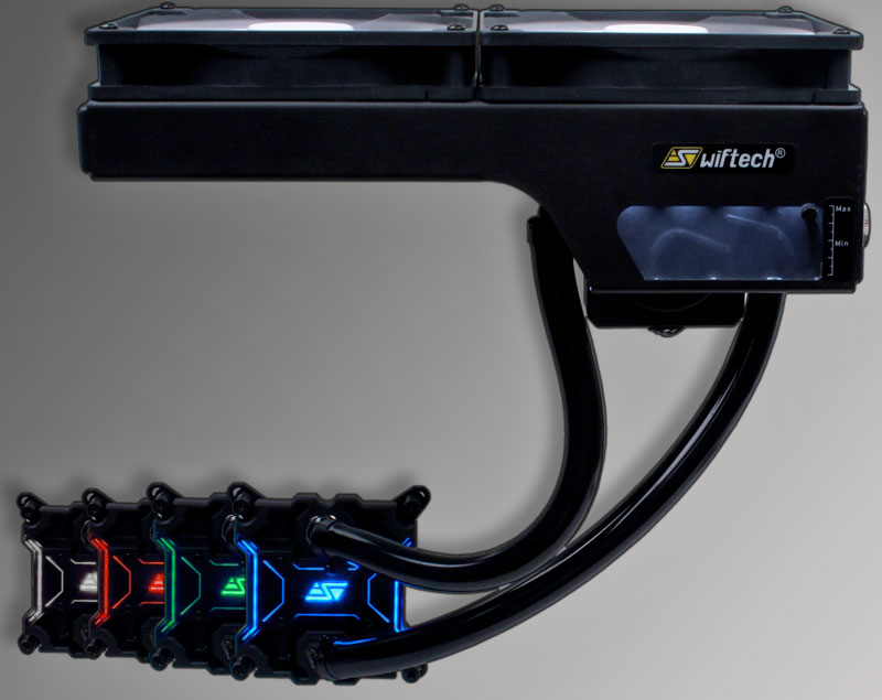

Considered looking around for one of these to try out as I could even use it on a build down the road maybe, but not sure it's worth messing with.
http://www.swiftech.com/H240-X.aspx
http://www.guru3d.com/news-story/h240-x-cpu-liquid-cooling-kit-released.html
http://www.overclock.net/products/swiftech-h240-x-cpu-liquid-cooling-kit
It's a bit different than a AiO it looks and expandable with some good parts with it to begin with.
Never tried liquid, might give it a shot in the future, might tame the X5680 a bit and usable down the road.
