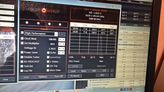

The X9000 is an Extreme CPU so you can definitely overclock it by using ThrottleStop.
If you can find a way to keep it cool, 4000 MHz is possible.
Unclewebb, absolute legend.
I need to pick your brain sometime on why I can OC certain systems with E5-1650 v1, v2, and v3 CPUs, and not others. It's bizarre.
