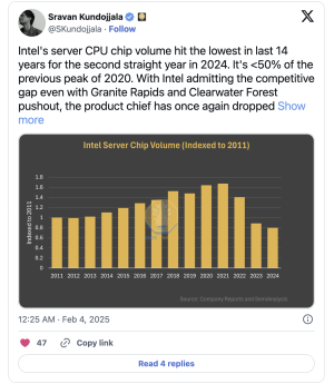

My original statement regarding this was wrong. It's 50% shipped to top hyperscalers. So probably AWS, Azure, Google, Oracle. They take up lion's share of the market anyway. Doesn't really change my conclusion which is that x86 is quickly being eroded in the server.
Fast forward to today, the adoption of Neoverse has reached new heights: close to 50 percent of the compute shipped to top hyperscalers in 2025 will be Arm-based.
It's not just Epyc causing Intel's server CPU share to collapse. It's mostly ARM.
