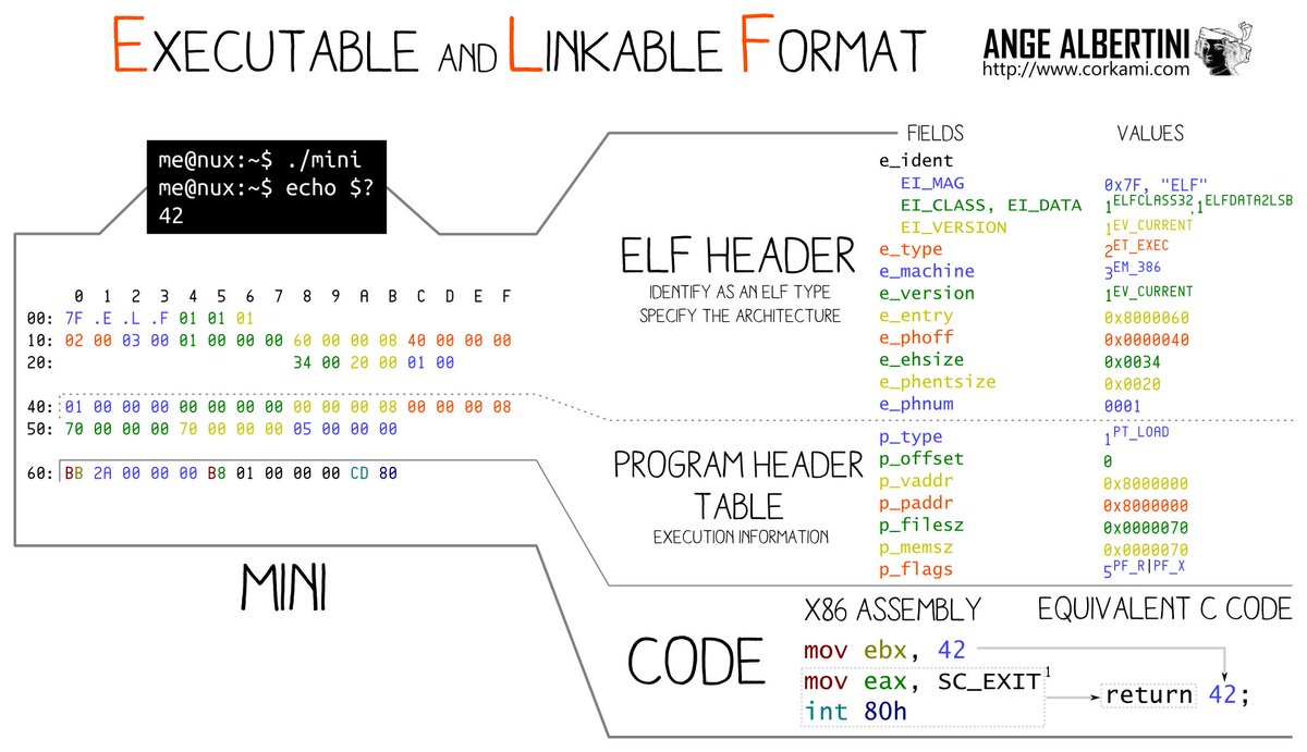

Hello,
When writing kernels and OSes in general, whether it be in assembly or something higher level, you need to assemble or compile your code in flat binary, right?
You can't assemble it or compile it to anything like ELF format or anything like that, right?
If you did, the processor would misinterpret the formatting as code and start executing unintended instructions.
After all, you format executable binaries so that the OS knows where code and date segments start and stop and then can load them into the GDT and add them to the paging structures.
But if the program you're writing actually is an OS, then it won't running over an OS like a user app will as it IS the OS, right?
That is, the OS runs on the metal, not over any other software.
Am I correct here?

Yes.
Though generally there is a bootloader + OS. The bootloader is that flat binary and it simply serves the purpose of choosing which version of the OS you want to load up.
I'd look into Grub to learn more about how semi-modern boot loaders work.

How can the OS be assembled / compiled into some kind of format?
You write code to load your OS, of course. :)
The bootloader really just does the bare minimum amount of setup necessary to hand control over to the kernel's startup code. That code has to do a lot of set up, such as doing some very basic memory initialization and taking the CPU from 16 bit mode to 32 bit and ultimately 64 bit mode. It loads the kernel into memory, and will eventually call the kernel's main function. Only then does the OS itself really begin to boot.
You will probably find this interesting: https://0xax.gitbooks.io/linux-insides/content/Booting/linux-bootstrap-1.html

Hahaha, if you want to write your own OS, why do you care what format it is. You can lay it out any way you want.
I'm not talking about the format of the OS itself. I'm sure there are an infinite number of ways to organize the data structures and control mechanisms that constitute an OS.
I'm asking about the format of the binary that constitutes the OS's machine code.
If I tell the assembler to output my source code in ELF format, for example, then when the bootloader loads the kernel into memory and sets the instruction pointer to the head of my kernel's binary, the CPU will interpret the header information and formatting info as instructions to be run even though they're not meant to be treated as such.
Get my point?

If CPU is set to execute the code from the code section, why will it execute the header portion? header portion is data, not code.
x86 CPU has an instruction pointer to tell it where the code address is and where to start.
