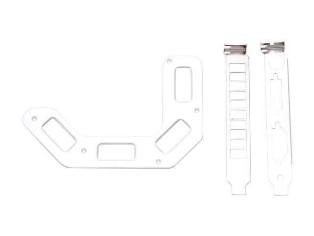

Does the NV5 Revision 3 come with heatsink pads on the cooler, or do you have to
put them on yourself (as oppposed to the picture)
The reason I ask, I picked up a NV5 Revision 3 from Frozencpu, and it will NOT fit
on the BFG 7800GTX, as the heatsink to right edge of the card does not allow the cooler to make contact. Thermal pads were included, but their were only 8 small ones, and those were needed for the memory chips on the card.
By the way, this is NOT a product I would recommend, the thermal pads stickiness is HORRIBLE, and as I stated, it will not fit on the BFG 7800GTX because of the heatsink to the right of the GPU. So much for Revision 3.
Can someone confirm the thermal pads for the memory chips as being already attached to the Silencer, or if it has to be done manually, as there is not enough thermal pads for the 8 memory chips, as well as to remove the Heatsink from the right of the GPU and attach thermal pads there.....

I'm not sure what the difference is between the eVGA GTX and the BFG GTX, but it fits on the eVGA. The little heatsink to the right of the core does appear to push on the NV Silencer a bit, but contact is being made with the core. You do not need to remove that little heat sink, and you don't need to put thermal pads there, since the cooler isn't meant to cool that part of the card.

As far as the stickiness of the rear RAM spreader pads... Yeah, it's ridiculous... I used the spreader from the cooler that came with the KO instead.

The thermal pads for the memory are not attached to the cooler... When you get it, they are in the right place on the cooler, but the come right off. Note, the ones for the front are different that the "sticky" ones for the back, on a GTX you will only need four of these.

Mine had the main gpu pad and fit just fine. BTW> although at first it appears the heatsink for the rear memory doesn't work properly, once heated up though, it sticks like glue. i thought the same as most of you, until i tried removing it after a couple of days...wouldn't budge.

Doesn't the 7800GT have all 8 RAM modules on the front of the card as opposed to the 4 on the front and 4 on the back? If so, you don't need to wait until they fix the sticky pads for the back because you don't need the rear heat spreader... The wires are easily flipped the right way if you get one that has them hooked up wrong.
