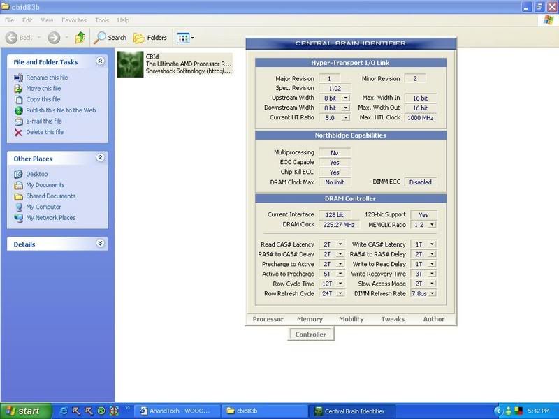

there's a program out there that you can adjust the HT ratio and RAM ratio for the Dell E521.
I think it was called CBiD
what version of cbid are you using. my memory/controller screen doesn't offer ht info at all.Originally posted by: Dazed and Confused
HT Adjustment in CBiD
Click "Memory" then "Controller" and its on the upper left
From what I've heard the best ram to OC the DELL E/C 521's is the DDR2 533 that can run at least 600mhz at 1.8v. For some reason these things hate faster ram when it comes to overclocking cause of the limited dram voltage![]()

Got an 800MHz overclock on my x2 3600+ powered E521 - had to bump down the memory ratio to /10, but even with the slower memory speed I shaved an honest 36 seconds off a 2MB Super Pi run.
