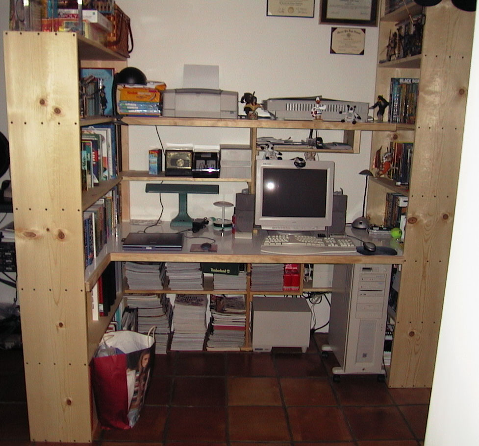

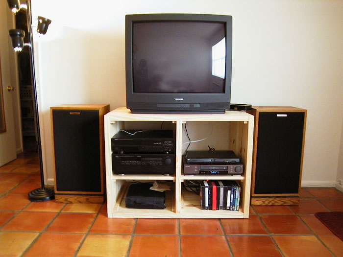

I know much about woodworking I built this unit temporarily until I get a house My desk, about 84" x 84" x 42" and a simple TV and A/V stand. The desk's picture would be better if I could back up about another 10' to take the picture....the tv stand has slide out shelves. Both have cable management and you can't see wires anymore on either. I have also built a full built-in unit in my old house. It would be foolish to do that here though as this place is too small.
My next project is a L shaped nook for my kitchen with storage as well as a coffee table and end tables.
My tools however probably add up to $10k or more....I have about 1000-1500 hand tools, all mechanical sockets/wrenches/etc in standard and metric up to about 1 1/2" and 36mm or so. I have a powerful hand circular saw, cordless and corded drills, dremel, belt sander, orbital sander, router, 2ton and 4 ton jacks and stands, 3 different ranged torque wrenches, plumbing tools including pipe cutters up to about 4", painting gear, 1 40' and 2 20' ladders, bench grinder, vice, and a 10" table saw and radial arm saw. There is probably more a lot of this stuff I keep at my father's until I get a garage back.

Last post, I promise.
Your computer desk and AV stand are prime examples of why you shouldn't even be attempting to offer advice.
Both pine (not hardwoods), nail heads showing & very obvious joinery. Your projects are examples of what I'm trying to avoid.
Nail heads showing
Very crude joinery
The edges haven't been routered, and your work doesn't appear to have had a finish applied.
Respectfully suggest you refrain on giving advice on woodworking....

Ok, I just went back and looked at that thread ... OMFG, what a complete ass. And judging from the quality of the work in the pictures you posted, you're in no position to advise on woodworking matters either. I mean, exposed screws holding up your shelves, no face frames ... I wouldn't load those shelves to heavy, they're likely to split out on you. And that bit where the desk on the left side sticks out about half an inch from the shelves ... a nice touch.
I'm not suprised you've never found a need for a jointer or planer ... I mean when you're buying S4S pine @ Home Depot, what's the point?
I normally wouldn't criticize anybody's work here, but you asked for it in a big way ... and dragging in moose's ex was only the icing on the cake.

I used maple for my old house...the kitchen cabinents, the flooring, and my wallunit/living room was all maple, but there is nothing wrong with pine...down here in Florida pine is used even in the most expensive of furnishings.
Like I said these two units will probably be trashed when I move out, if I had the room the desk would be about 84"x96"x60", the console would have regular drawers, glass doors and shelves....you cannot buy a 26" deep console easily. The pieces in this place with the mexican tile look very good. The 'screwheads' actually look good with the rustic decor here, I had ripped a bunch of pine to cover them, but once it was up the effect was perfect. The 'crude' joinery it not joinery at all I used 90 degree butt joints, however, they are very solid and again this was just a project that may be used for 1 year...perhaps 2. 90 degree is about what most furniture uses. You want to get in to dovetailling, dowels, mortised, whatever you are not going to plan on trashing it.
No finish either, no need for a finish on these...the desk top is whiteboard and has been routed. I have polyurethane as well as a stain I could have used....the white wood contrasted perfectly with the reddish clay tile.
Types of wood, finish, hardware and joinery are all based on what you are trying to accomplish....early american cherry would not look good in a beach cottage. Rustic knotty pine with iron hardware would not look good in an elegant dining setting. Pine (spruce) was more of a choice of not only low cost, but also availability of 12" board widths to eliminate the need to glue and clamp boards.

I don't think you know what you are talking about....I had two bookcases with the exact same construction for approxiately 6 years in a room to store my books one was 48" wide, the other 42"....only the 48" sagged slightly on one shelf that I didn't center brace. Like I said these project are temporary work areas....you will not find anything commercially available that could suffice for this same storage need in the same space constraints.
s4s (4 surfaced sides) is never usually good enough to take straight to assembly, surely you know that.

LoL ... justify it all you want, 10K worth of tools to produce dorm room quality furniture??
And 90 degree butt joints are joinery ... just not very good. A simple dado joint would be far stronger, stiffer, and nicer looking. As for the finish ... I guess if you plan on trashing it, it doesn't matter, but that's going to look pretty crapy in awhile because you can't really clean it.
You'd have been just as well off with some cheap particle board crap, and could've save yourself alot in tools.
In any case, I find it terribly ironic that you see fit to criticize or affer advice regarding woodworking!

You aren't getting it....you are wanting to bash and cry and scream....you are missing the points.
I am in this apartment for a 7 month lease....I will probably renew it once and then be in a house.....absolutely anything I build here will be trashed on me leaving. It would be stupid to pour money into $500-1000 in wood....these pieces are custom to the location and would probably not work elsewhere.
Dados would only add to increased project time and not add anything worthwhile. 1" pine with a simple butt joint is capable of supporting a ton of wieght. In my old wall unit I used butt joints for the ends and partial dados for the interior pieces (gave a blind front joint). As far as unfinished woods go they aren't going to be good for liquids and stainables....sanding can cure a ton of problems....but again I have finishes...these look better without them and even if needed to last 2-3 years there isn't going to be a lot of chances for them to get dirty. My desktop is impervious to just about anything and that's the only working surface I use.
