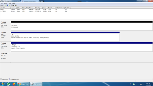

Won't recognize 4TB HDD at full size even though I already have a 4TB HDD installed.

So I recently purchased a Seagate ST4000DM005 4TB HDD and Windows 7 Disk Management is only recognizing the drive as 1677.90 GB. However I have a Western Digital WDC WD40EZRZ 4TB HDD that I've had for almost two years and Disk Management recognizes it as 3725.90 GB. I tried downloading Seagates Disc Wizard tool and the disk management portion recognizes both of the HDD as only 1.69TB, even though the one HDD definitely using more space than that currently. I don't understand why it won't recognize one HDDs full capacity but has no problem with the other.

Have you tried going to Computer Management, and then inside of it Disk Management? See if maybe it's recognized but just partitioned funny. If so try to extend it, maybe deleting whatever is in front of it if anything. If this sees it as the 1.69-ish as well that might lead you down a different path.

Disk Management shows it as one single 1.69~TB drive. It is partitioned using GPT (GUID).
The HDD is connected directly to my motherboard via SATA. I even tried using the port and cable that the correctly recognized 4TB HDD is using and still no dice. Device Manager says that I'm using the latest drivers for my SATA controllers.
