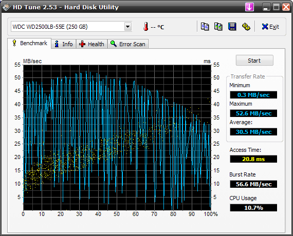

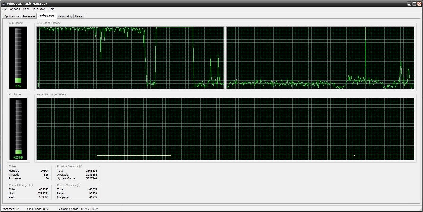

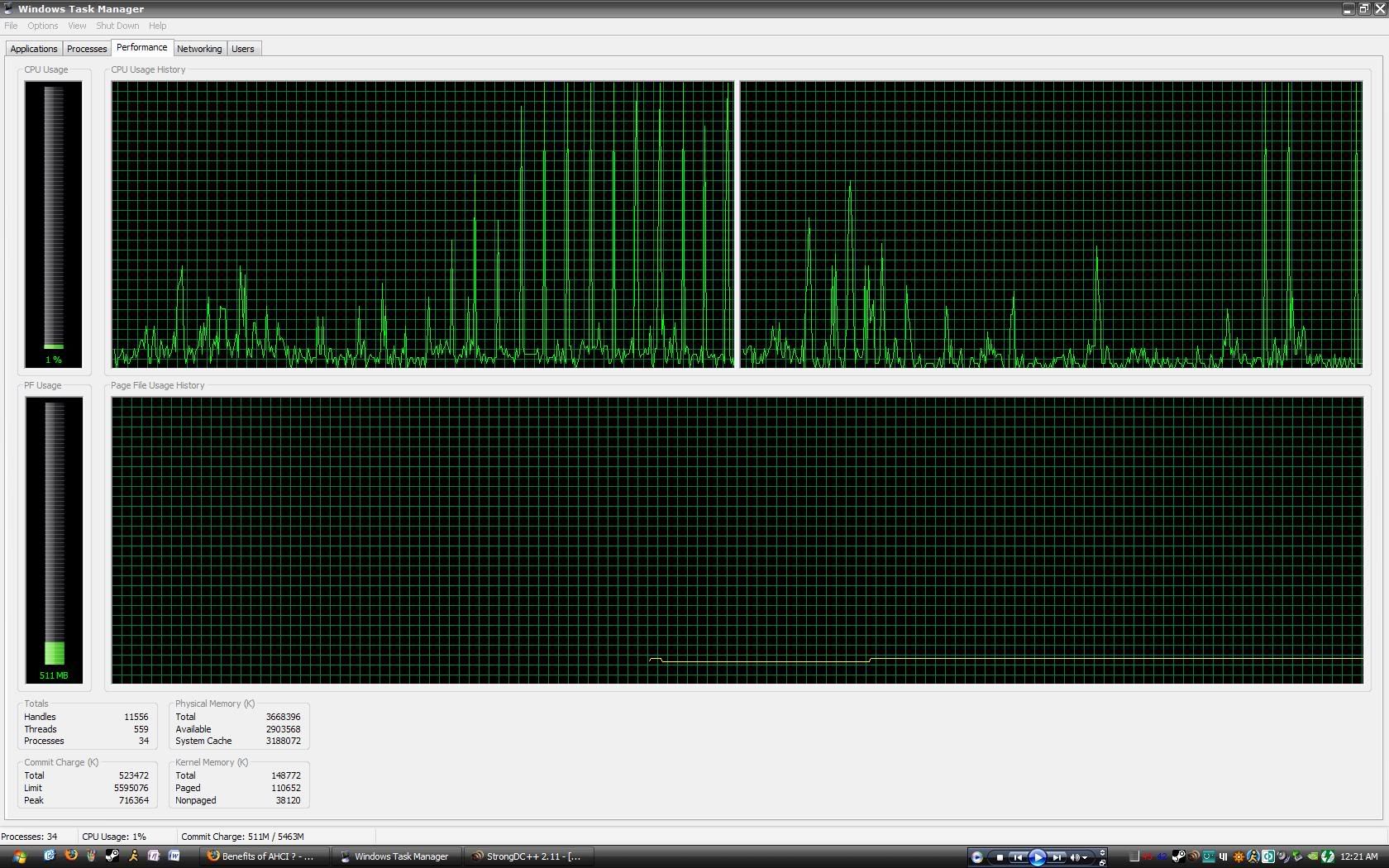

I put the two in RAID, but after some performance and random CPU spike and system lockup issues (see image in task manager). Also, the transfer rate on one of the drives in the RAID array was excrutiatingly slow (see image).
CPU usage while transferring data in the meantime was very, very high as well).

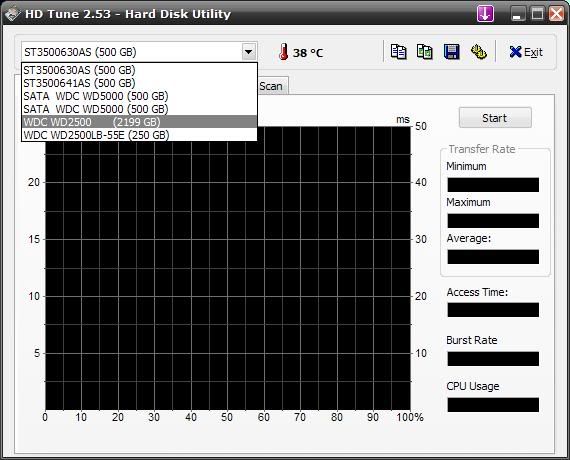

Recently, however, my BIOS won't detect one of the WD2500LBs, but rather, recognizes a partial name (a proper detected name would be like "WD 2500LB 15.05R" but the BIOS detects one of the hard drives as simply "WD 2500"). Disk Management doesn't reveal this missing drive, as well.
HD Tune also detects a strange drive in the list (see image) as "2000GB", which is obviously wrong. This is one of the stranger parts of my problem, as my missing hard drive is misreported on POST and is missing from Windows.

- The hard drive is dying, this hard drive is a refurb drive bought from Woot a couple years back, and there has been talk of these drives being bad from the getgo. I suppose its time has come? That wouldn't explain, however, that I could access the drive (albeit with very very inconsistent drive performance [40MB/s to 1MB/s and back and forth]). Is it possible that I can RMA this drive back to Western Digital?
