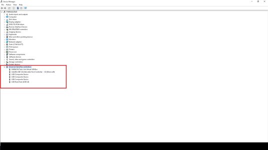

If the USB hub is connected to or disconnected from the desktop still device manager showing same list under : USB Serial Bus controllers,,,,,,wouldn't that mean the desktop not recognizing the USB hub ?
I did a test by connecting StartTech dock station and it is also not getting recognized

Paperdoc
Aug 17, 2006
2,442
345
Plug in that docking station and make sure it power brick is connected. Check that it is not shown in Device Manager. Look in a few other places like Disk Drives and Storage Controllers. Then try this and re-check. In Device Manager click on the very top item, then on the Action menu item at top and choose "Scan for Hardware Changes". This forces Windows to look again for everything attached. When it has finished, look in your list again for that device. THEN also look for your USB3 Hub.

If the USB hub without anything connected to it not showing in the device manager wouldn't that be an indication there is something wrong it? Or something has to be connected to it to be shown in the device manager ?
Paperdoc
Aug 17, 2006
2,442
345
You are right about that. Connect things that way - Hub in, but nothing plugged into that. Check in Device Manager to see it it is there. If is IS there with a yellow triangle, it has a problem that MAY be as simple as re-installing its driver. If it is there and looks OK, try that process above: UNinstall the device, back out and shut down, boot up without it, check that is it NOT there then shut down again. Reconnect it still with nothing plugged into it and boot up. See if it has appeared and is OK. To be sure, try the "Scan for Hardware Changes" step to force a driver install, and see if it appears OK now.
