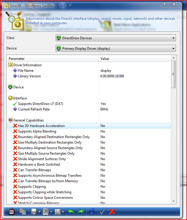

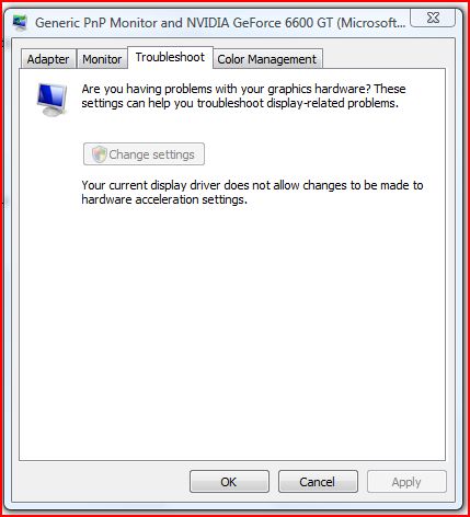

Someone recommended turning off hardware acceleration. I came to find out that "Your current display driver does not allow changes to be made to hardware acceleration settings. Additionally, SiSoft Sandra was reporting that I had no general capabilities

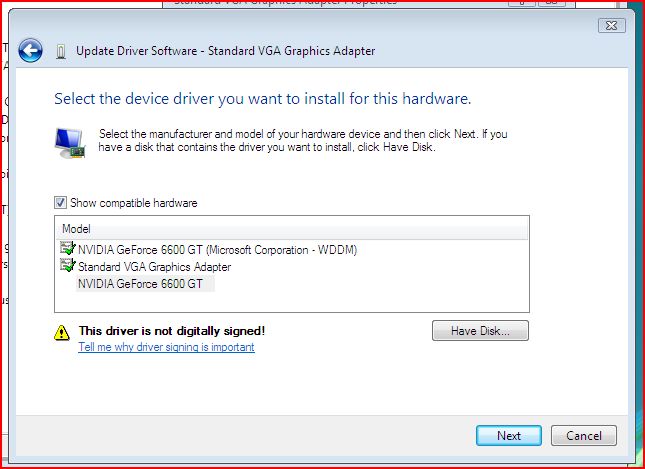

I thought, maybe it's the latest ForceWares? I was only able to find a modified nightly ForceWare driver though another forum, so I decided, why the hell not? I went to manually update the driver when Windows finds two graphics adapters.
If I double click on "Standard VGA Graphics Adapter," I have no problems. (other than the max resolution is 1280x1024 and is fuzzy, but there is no lag when doing CTRL+ALT+DEL and I can adjust Hardware Acceleration.

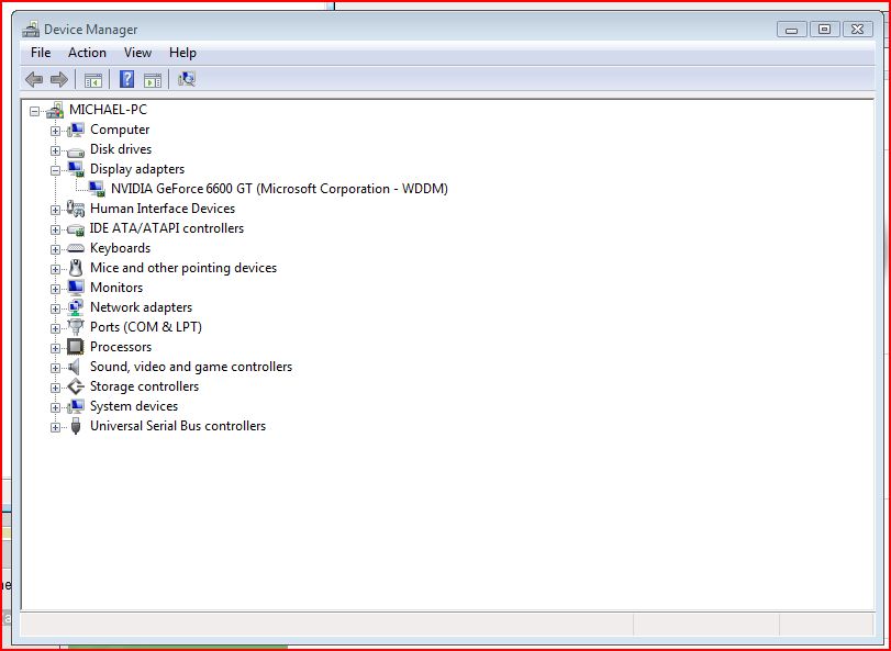

If I double click on the top "NVIDIA GeForce 6600 GT (Microsoft Corporation - WDDM)," all the problems resume but I can get 1680x1050 resolution but there is that black screen lag + no hardware acceleration.
The lower "NVIDIA GeForce 6600 GT" does the same thing as the (Microsoft Corporation) one.
