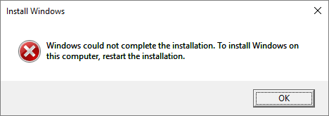

Recently my old laptop (INTEL) and my brand new mini pc (AMD) just refuses to deal with Windows installation, it could be Windows 10/11 or even Server. The Windows server installer just won't see the NVME SSD in the BIOS on the HP Intel 10th gen laptop, but when it boot into the installer, it will proceed to where it see the partition, then it stop to continue.
I have flashed the newest BIOS firmware, tried MBR, EFI partition on different internal disks, even used diskpart utility to erase disk or convert disk over and over, yet nothing works!
I have been struggle to do anything for over a week. Somehow, someway I eventually re-installed Windows 11 on HP laptop. And the only way I can use the new mini PC is use the recovery image directly from the vendor!

Since you were able to boot into SSD3, so extract the Win10 ISO file into a folder, then rerun Win10 setup, see if it can add SSD3 Win10 installation into Windows Boot Manager
Tried, didnt work...Windows went all the way through the installer, but because it wouldnt boot after a restart, the installer automatically reset to the old installation for safety reasons.
