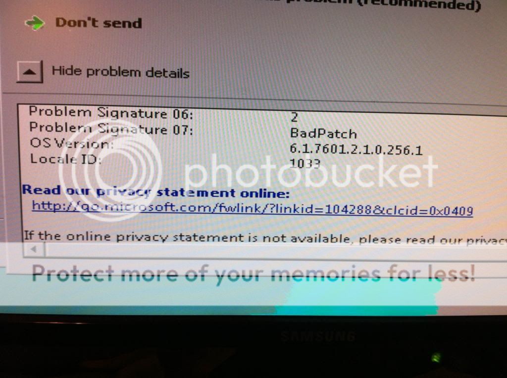

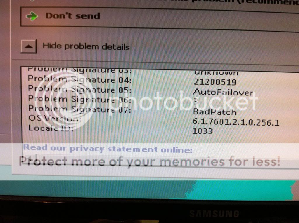

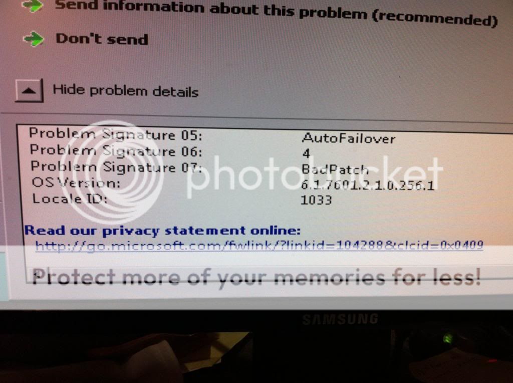

I have now unplugged all HDDs except the SSD and booted up. I got BSOD right as the Microsoft status bar began to appear onscreen (i.e., same error at the same place as my original post). Computer automatically rebooted, but this time I was able to boot into Startup Repair. It ran the default Auto Repair but this failed - the error message can been seen here and here.

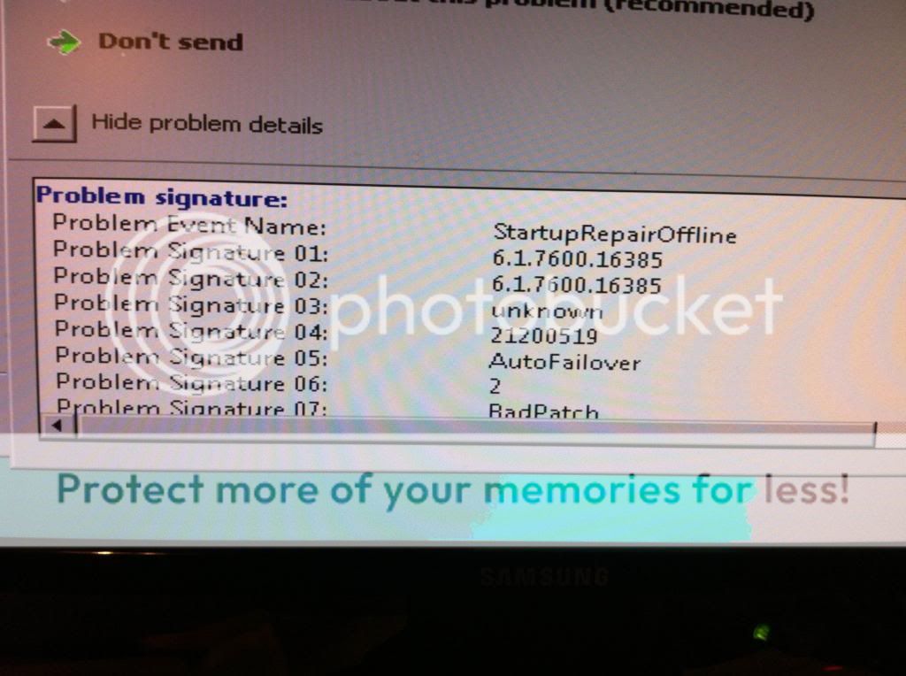

I then went into Advanced Options and ran the Windows Memory Diagnostic Tool. The test ran all the way to 99% without an issue and then just before it turned to 100%, I got the BSOD again. After automatically rebooting, I ran the same test and got the same result again. Error messages can be found here and here.

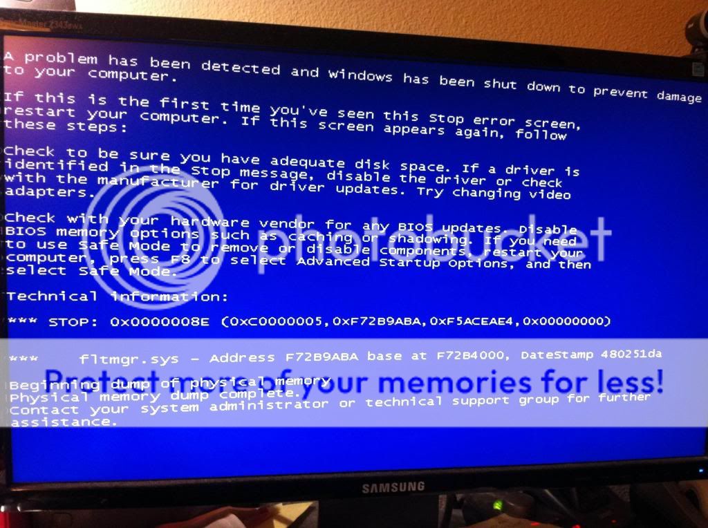

Next, I unplugged the SSD and plugged in the VR. Win XP booted up normally and after logging on, there were several messages stating that XP was not activated. I denied all requests and then XP automatically logged me off. Then, I got the BSOD again, except this time the computer froze and did not reboot - here's the BSOD. I pressed the power button for 5 seconds to get it to reboot.

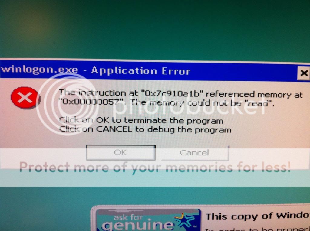

I logged into XP again and went through denying the activation process. I got kicked back to the log on screen and tried again - no BSOD this time. After again going through the non-activation process, there was an error message about the memory: here. Now that I come to think of it, I was getting error messages on reboots when the computer was still functioning, they may even have been the same message, although I'm not sure.

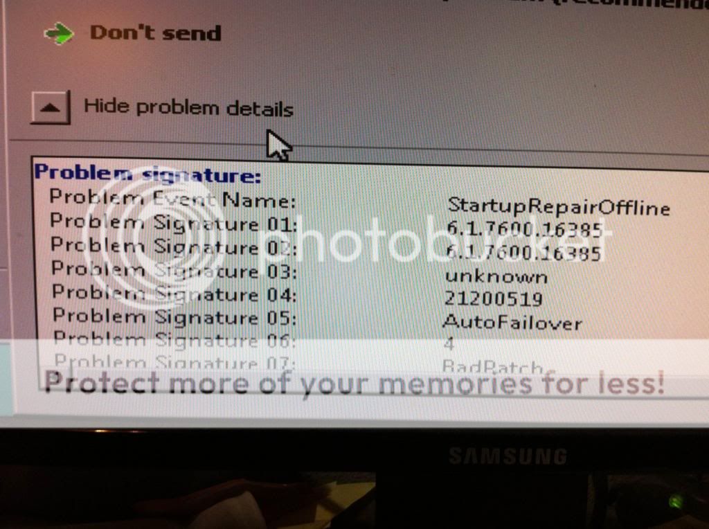

I unplugged the VR and replugged the SSD. Booted up, same error. Shut off the computer and removed one stick of RAM. Ran Startup Repair (auto repair failed here and here), then the memory test and had the same issue (BSOD at 99% completion). Tried the other stick and had the same issues, here and here.
