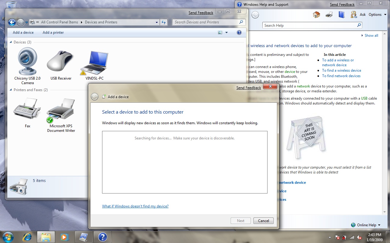

I noticed that on my lappy too - wasn't seeing E-drive (the card reader) - thought it was just me.
I really didn't pay any attention to why it wasn't (ahem) reading my reader. Guess I'll check it out, now that you mentioned it.

I noticed the same thing in my computer until I inserted a SD card and then it showed. You can also go to disk management and see if it's there - might have to assign the drive.
