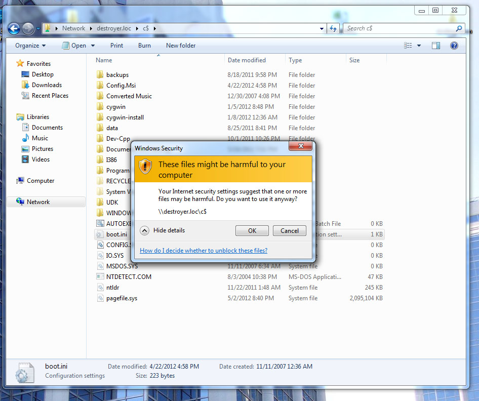

This is something that is driving me nuts. It seems at random when I go to open files I will get a variation of "are you sure" type dialogs. They're not always the same. UAC is disabled.
I will sometimes get the "are you sure you want to open this file" dialog. othertimes I will get "these type of files can harm your computer". Basically, some warning of some sort, at random. These files are on my network, and I trust them, I don't need windows trying to convince me that they could be dangerous. Even if it happened to be a virus and I did not know, the virus scanner would hopefully pick it up, otherwise this warning is useless because I'd be clicking yes anyway.
Is there a catch all way to get rid of all these warnings?

The one I'm having the most trouble with is the one that says "these files might be harmful to your computer" which happens when you go to move a file or right click on a file in a network location. VERY VERY annoying. I can fix it on a per server basis by adding the server in the trusted zone, but is there a catch all way of stopping this irritating dialog? Adding 10.*.*.* does not work, it seems to only work with host names. I also can't do *.loc as it wont accept that wildcard.
UAC is turned off.

You should probably turn UAC back on, there's really no reason to turn it off in Win7. And what is the exact wording of the warning?

Is your server on the same subnet as your PCs?
Possibly Windows thinks that the files on your server are in the "internet zone"?

This is the warning I get:
If I add it to the intranet zone it goes away, but I really don't want to have to add every hostname I got, it's kinda rediculous, and it's still going to do it if there's a foreign machine that is on my network and I need to get files from it. It's just an annoyance that serves no purpose really.
This happens if I right click or try to do anything with any file.

I just want to disable this dialog globally. I tried adding the entire /8 subnet into the trusted zone but that wont work, it has to be by hostname.
Oh and to make matters worse the computer in that example is actually on the same domain as my PC. That alone should tell windows that it's a trusted PC.

If I had to guess, I'd say one of the security settings you've changed in order to make it "easier" for you broke it then because I definitely don't see that on our work network for domain joined servers. My Win7 VM is pretty stock in that regard and I don't get those.

I've not really changed any Windows 7 networking permissions settings or anything, and I've gotten that dialog once or twice, for some text files (.TXT) sitting on my NAS. No other files seem to cause that, and I have no idea why a TXT file would be bringing up that dialog. I agree, it's very annoying.
You might try stripping off the alternate streams off of the file, perhaps Windows has "tagged" the file with zone info, that causes that.

That works but it's on a per system/IP bassis. I want to fix it globally. I suppose I could add every single IP in my network range...
ex scenario: I bring someone's machine home to fix it, hook it up to my network and want to access the files, it will bother me again. I just want to get rid of it completely.
It seems to be random too, it does not do it with all files, but it does do it with most of them. At one point it was even doing it on my desktop. I'd right click / drag a file so I can get the extract menu and get that warning. very annoying. Turning off UAC stopped it locally though.

For some reason wildcards don't seem to work, that or if I'm accessing it by hostname it does not check the IP. 99% of the time I'm dealing with my main server so I set that one hostname up, and guess if there's no way to get rid of that dialog I'll just have to live with it for the few times I access another machine. You'd think there would be a way to turn that off completely though.

Only issue is if a user does download something that happens to be malicious and they don't know it's malicious, they downloaded it for a reason, and they'll open it, and click yes like every other file they trust. The whole idea of prompting is still useless. As for the CD analogy, if it asked you that every single time you played a music CD, not only would it be annoying but it would be second nature to click yes every time. The whole concept of prompting because there's a slight chance it's bad, is flawed.
This particular prompt also happens for simple tasks like moving a file. Even if it WAS infected, moving it wont magically cause it to get executed, and lot of these files are not even executable in first place.
