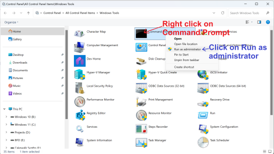

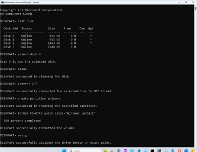

Hi William,
You can convert an MBR disk to a GPT disk simply by going into Diskpart (type in "Diskpart" at the prompt) in a command prompt (as administrator). Now type in "list disk," and select the desired disk by typing "select disk #" (just exchange the "#" with the desired disk number). Type in "clean" to delete all items and partitions from the disk. From there you can just type "convert GPT" and that will do it. Now you just create the desired partitions and format. (Let me know if you need instructions for Diskpart.) See screenshots attached.
Kind regards,
tecknot
Reactions: William Gaatjes

Hi,
That is an option that is not possible for me. Because it is my main SSD where windows is installed upon.
And all options are greyed out even when logged in as admin.
Best is to boot from W11install USB stick,
I will do a fresh install , disable CSM to enable UEFI booting. And remove all partitions then on my SSD and convert to GPT with diskpart, list disk, clean , convert GPT.
Then fresh install W11.
I have only 3 partitions on my SSD and it seems MBR2GPT.exe can handle that while W10 is running. But it is strongly recommended to make backups.
Because sometimes MBT to GPT conversion with MBR2GPT does not work.
And the only solution then is either restore from backup or a fresh install.
