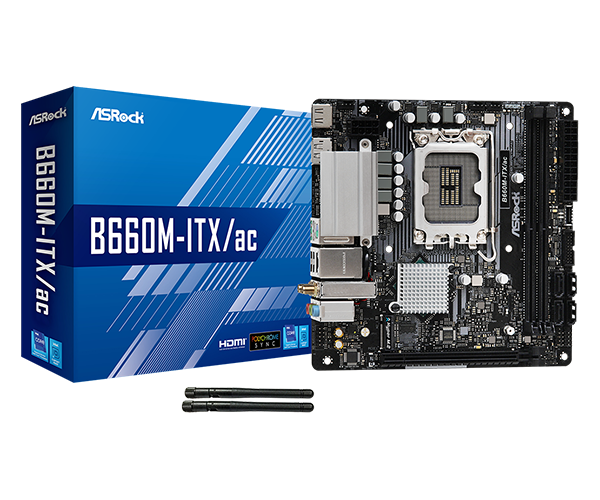

My PC:
Core i3-12100F, 8 GB RAM 3200 MHz, ASRock B660M-iTX/AC, RX 6500 XT, 250 GB Lexar NM610 SSD.

The only reason I brought that up is the mention of RST drivers in your OP.
There might be an option in the UEFI screen to disable it. Windows typically won't need an additional driver for 99.9% of NVME / SSD drives though.
The next thing I would check is the UEFI for an update. When I got my ASR board there was already a couple of newer releases available on the website even though it was at launch for ADL.
Looking at it there doesn't seem to be many changes but, like any other "driver" they don't go out of their way to publish all of the changes being made. Seems my board needs an update as well jumping from version 2.x to 10.x but more importantly the microcode update secures things.
