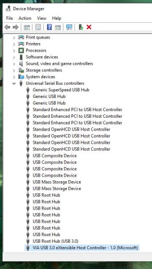

Have you tried to update your USB drivers, check power settings.
Here's a screenshot. Not sure why there's so many USBs listed there, but none with an exclamation point.
The weird thing is, I only installed all the same exact software I had before I re-installed the operating system. There's absolutely nothing new installed on it compared to before the fresh install, yet I never had an issue like this until the fresh OS install.
I'm really tempted to just do another re-install. While the software checker said nothing is wrong, I am thinking it might be something it overlooks? I don't know, in all my years with PCs, I've never had an issue like this before. I'm really at a loss here.
Maybe I should delete all the USBs in the device manager and let it re-install them? I don't know if it would do that automatically though, or if I will just lose functionality of my USB ports if I do that?
