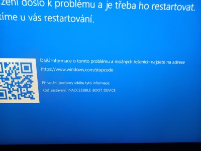

Hi folks, I have just changed CPU Ryzen 3700X -->5800X3D on my Asus TUF X570 MLB, but computer cant start windows (10). I updated bios before new CPU installation and I believe there is no problem how new CPU was assembled, I can get to BIOS etc., windows starting and show message that there is problem to launch the PC, windows is trying to repair it but no success.
Windows error message is: inaccessible boot drive (bellow screen), I dont have drives encrypted, I have just TPM module but didnt do anything with it and even dont have win version which would support it encryption, nevertheless when new CPU installed there was some message regarding TPM and I clicked yes to confirm I dont use TPM If I remember well.
I tried to search the solution (seems many have this problem) and found clearing CMOS could be solution, I did with MLB jumper (short-circuit) method but no success. I read better method could be to also remove the battery and then again use jumper but so far I was not able to remove the battery, its udder GPU and not easy to access.
Do you please think take out battery could help?ANy other solution or only one will be reinsall windows? Will it be possible to reinstall keeping applications or at least data?
Note: Strange thing, before new CPU installation, when PC turn on or restart fans started to spinning fast for short moment, but that is now not happening.
