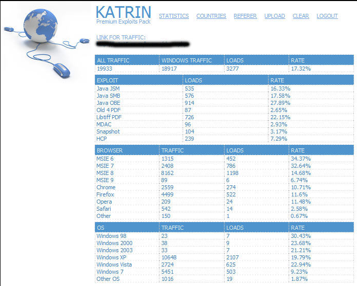

We would certainly hope so, but then there's stats from exploit packs that indicate Chrome users are nevertheless getting infected with some success. Maybe the explanation is that people are allowing it themselves?
If I didn't use 64-bit IE9, Chrome would be next on my list, but I avoid the thinking of "oh, I use this browser or that browser, that makes me safe. Because reasons." The bad guys are skilled and financially motivated, they'll find the loopholes and exploit them. My backup measures are SRP, EMET, and as little attack surface as practical (no unnecessary junk like Java). None of these relies on the reasoning that "well, THIS site is trustworthy, it's allowed to run scripts," when more than half the malicious sites out there would normally be safe.
