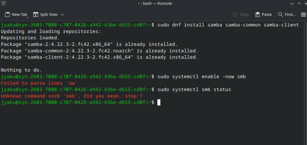

Interesting.. in fedora/ ultramarine now..
sudo systemctl --now smb
Unknown command verb 'smb', did you mean 'stop'?
It was
sudo dnf install samba samba-common samba-client
sudo systemctl enable --now smb
Enabling it after the install
After than, it would be:
sudo systemctl smb start/stop/status <~~~ not all three, but the one you need
It was
Thank you but I don't get it..
What is going on??
Well that worked..
jyaku:~$ sudo systemctl enable --now smb
Created symlink '/etc/systemd/system/multi-user.target.wants/smb.service' → '/usr/lib/systemd/system/smb.service'.
Thank you!

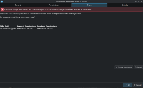

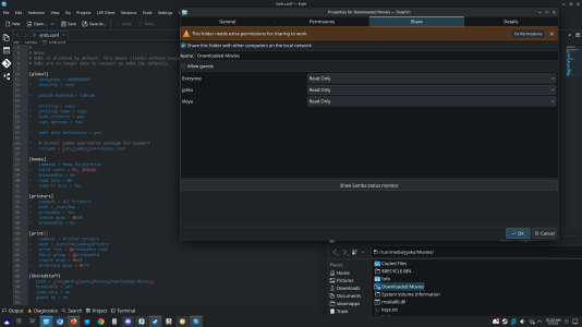

Am I doing this wrong??
I think I followed your instructions but I can't see the files on the windows computer:
The shared folder is on another hard drive called Movies and the folder I want to share is called Downloaded Movies..
I mapped it out but still nothing.
What happens when click fix permissions
I havent managed samba shares thru a gui, so new to me
This:
I don't mind typing out commands since I followed your instructions so far.
But I'm still struggling to set it up correctly.. feels like the first time I setup the windows network.. just need to learn how to do it once.
This:
From the samba side, focus on the config file and adding entries for shares in there. Restart the samba service (or reboot) for the new file updates to take effect.
Whats the run folder? Something u made?
