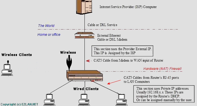

You are missing something.
In order for this to work you need a full 8 strand connection from the modem to a switch and then from the switch to each location.
As Larry said, telephone doesnt need this but a network does for sure.
In addition, if your Modem is Nor a Modem Router you need a Router too.
Plugging multiple computer to a regular Modem does Not work unless you pay for multiple External IPs.
