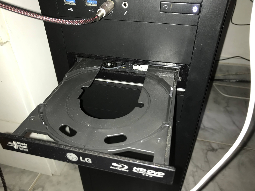

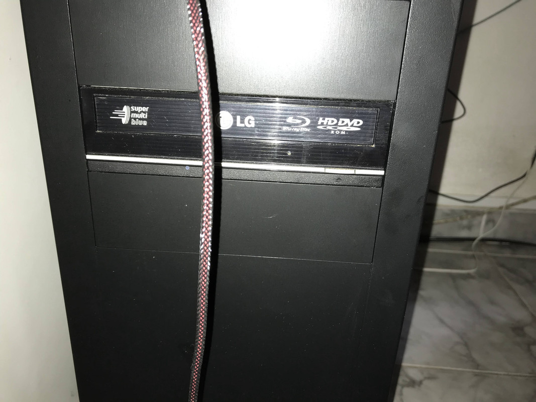

The GGW-H20L (which is an old drive just like this case) has
146 x 41.3 x 185 mm
W x H x D
Source:
While the BDR-S13UBK:
148 mm(W)×42.3 mm(H)×181 mm(D) / 5-13/16 in.(W)×1-21/32 in.(H)×7-1/8 in.(D)
So, this means the newer drive is a few millimeters bigger.
The problem it it's not depth. Is it?
This is how the old drive is currently installed:
So where do I measure to check if a new drive would fit there?
Dec 10, 2005
28,686
13,831
Wouldn't the problem be the height in this case? Is Pioneer making larger than usual drives? I never heard of this until now, and since this CORSAIR case was cheap, I am afraid that if the W/H is different, it will not fit. Just the fact this warning was put in the page, it makes me suspicious of that.
Usually it's the depth that would be the issue, such as another component or case piece that sits directly behind the drive. There are really only 2 types of optical drives for height: slim and standard, so as long as you're replacing a standard drive with a standard drive, you would only need to worry about the depth.

Fitment Notice:
The Pioneer BDR-S13UBK Internal BD / DVD / CD Writer's larger than usual front dimensions may not fit some 5.25 inch drive slots, meaning this drive may not fit in your Case.
Please confirm the dimensions of your Case's 5.25 inch drive slot(s) before purchasing this Pioneer Drive.
The W and H are rather "standard". Wikipedia writes:
> Half-height drive bays are 1+5⁄8 inches (41.3 mm) high by 5+3⁄4 inches (146.1 mm) wide, and are the standard
> housing for CD and DVD drives in modern computers.
Why would any case have non-standard bays and why does Pioneer use non-standard size?
Reactions: aigomorla
aigomorla
Sep 28, 2005
21,067
3,574
it looks like a standard 5 1/4 bay drive.
So yes it should fit... unless you a depth issue, which do not exist anymore as most PSU's are now mounted on the bottom of the case and not the top like they originally were.
