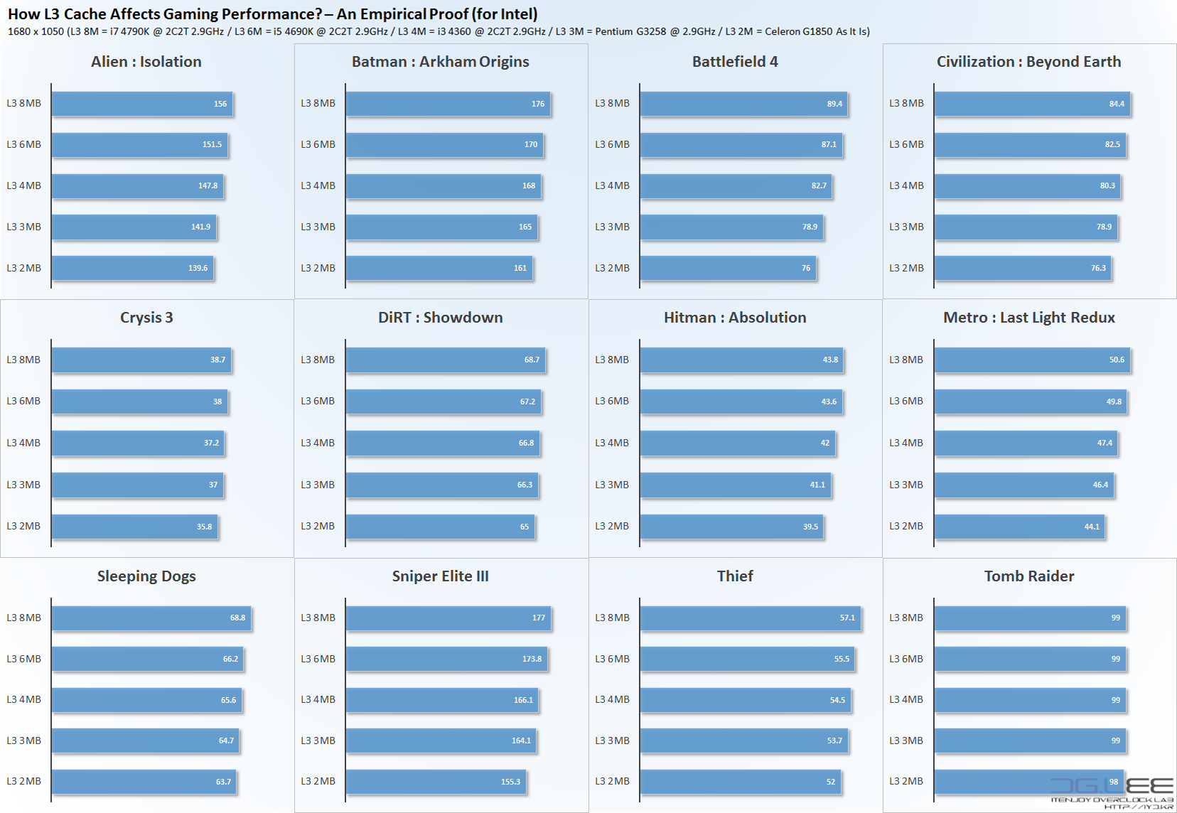

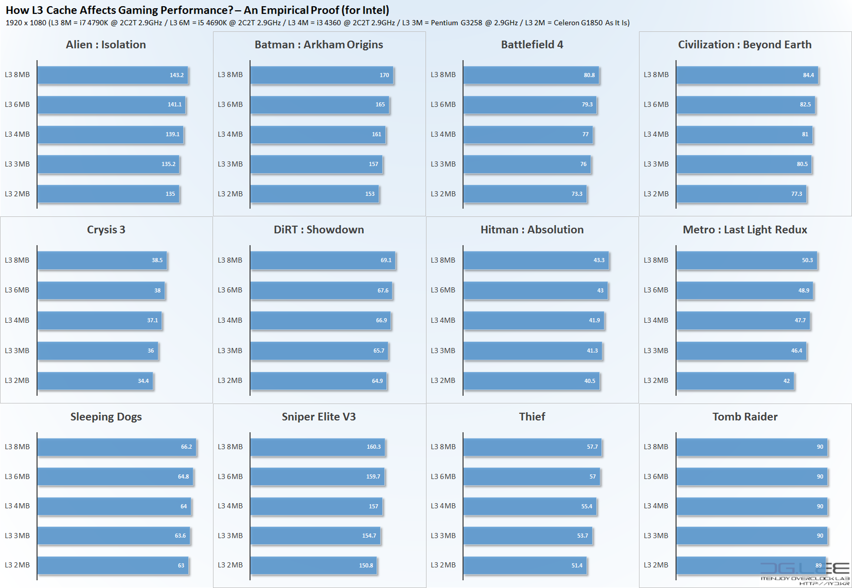

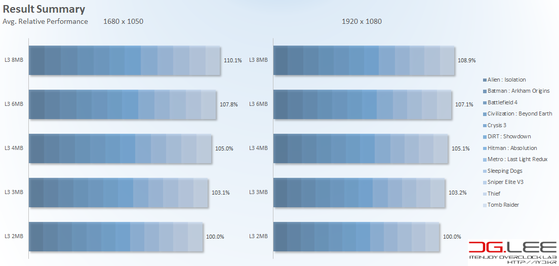

The impact of larger cache have been shown over and over in the history. You may have forgotten the time where AMD sold you double the cache on K8 with a premium and it performed better as well.
Isnt Santa just a Red Team membership? ;)
Note the low clock, Higher clocks would give higher difference. And remember all these are done on lower latency DDR3. And the uncore in Skylake runs faster.
221C4E37548447F31950FD
231F7D37548447F315518C
23146E37548447F32830C8
