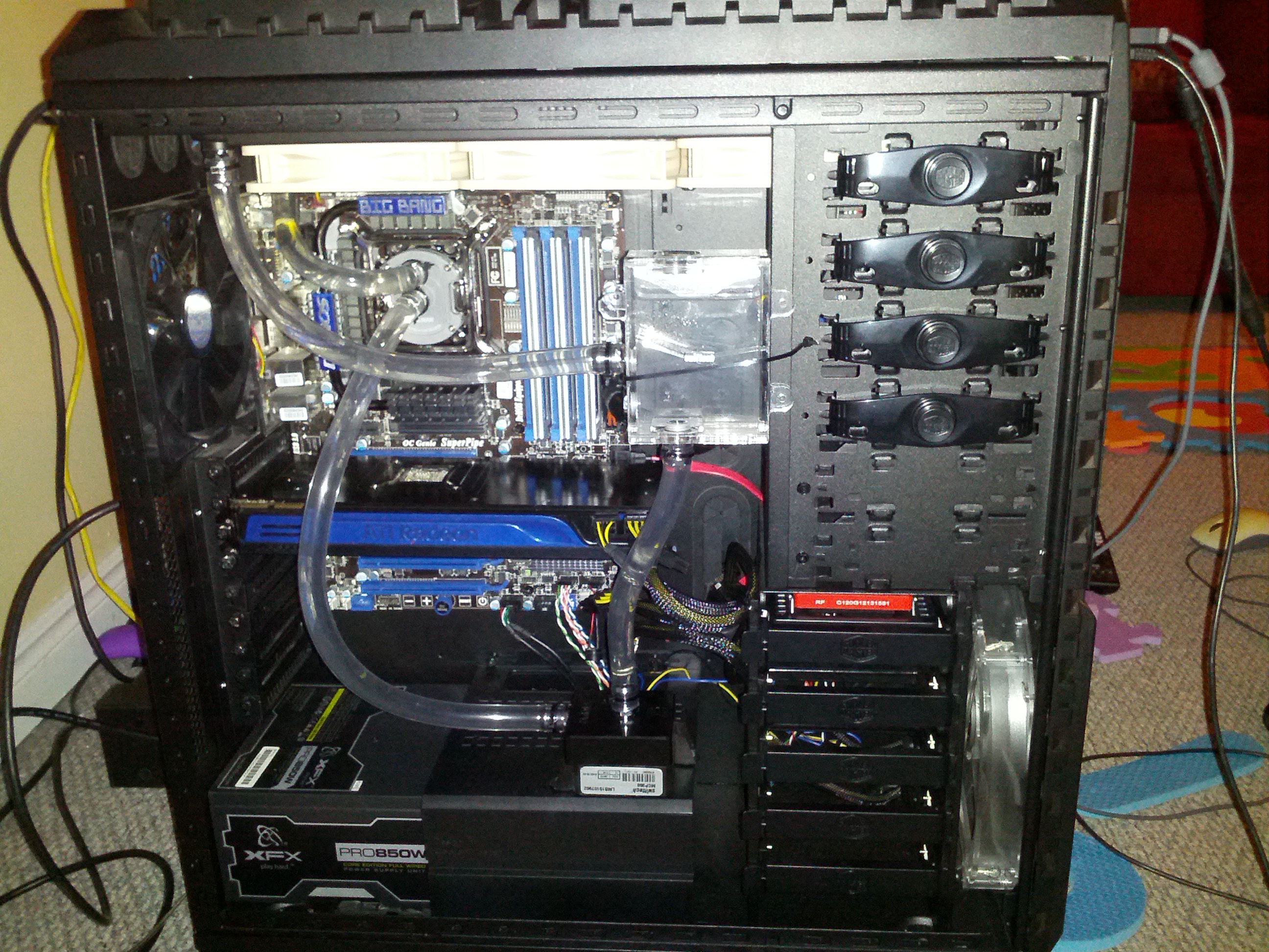

i put a 3x120 rad in mine.

It looks to me from your picture that you have six fans in that configuration, or three on either side of the radiator. So obviously, push-pull is also a possibility.
