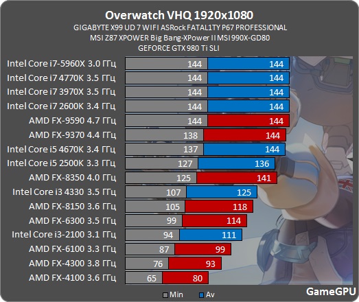

DX11 is not the past yet. People aren't playing ashes of the singularity, they're playing games like Overwatch which just released using DX11. Overwatch reached 10 million players after only three weeks.
You can push 100+fps with a sub $100 CPU (FX6300 or Core i3 ) in Overwatch, but you need a faster CPU in other games like Total War Warhammer, and DX-12 is what you want. Not to mention all XBone games will be DX-12 for both the Consoles and PC from now on. And every major AAA game coming the next 6-12 months will also be DX-12.
So nobody said DX-11 is dead, but everyone (NV Included) are optimizing both hardware and software for DX-12 from now on.
Edit: Ehm, you dont even need a dGPU to play Overwatch, not that much demanding game.
Please attempt reading the thread. I specifically mentioned that this overhead is more of a problem for people with high refresh rate monitors. Not 40fps or 100fps, more like 144/180/240. Has anyone seen an Overwatch 1080p min settings benchmark to compare like the videos I posted? I haven't.

Please attempt reading the thread. I specifically mentioned high refresh rate monitors. Not 40fps or 100fps, more like 144/180/240. Has anyone seen an Overwatch 1080p min settings benchmark to compare like the videos I posted? I haven't.
As i have said, you get more than 100fps with very cheap CPUs like Core i3 and FX 6300 if you have the GPU or lower Graphics settings. The game is not that demanding.
Now you're posting a benchmark using Nvidia cards. We have already established Nvidia has worked on and has a great DX11 driver. Plus this benchmark has an fps cap enabled.
This is your second post that completely misses the point.
The point is that Overwatch is not demanding and IF there is a CPU overhead on the AMD cards you sure will not have a problem with it because you will still get more than 100fps.
I don't believe i3 and FX six cores will perform that well with AMD cards. I had a 2500k, overclocked, and during the intense firefights it would drop below 100 and into the 80s. Graphics were on low, too.
Since the game is competitive the intense firefights is where performance really matters. Sub-100 fps is not acceptable, especially for people with 100+ hz monitors.
