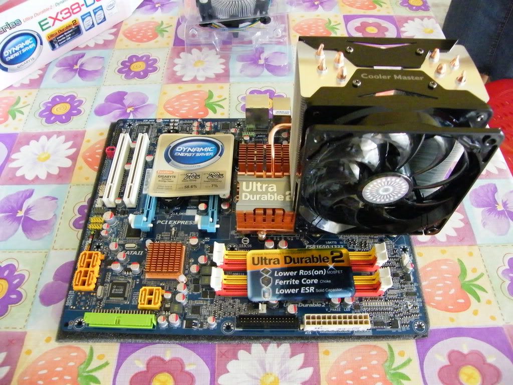

Thanks for that pic toadeater, helps a lot :) It's a pretty tight fit, I wonder how close to the PSU it will be...
Does the fan cover the first mem slot, or is there clearance for a module?

Hi, I have a ds3l with the 212. With the fan in the above pic config the fan just barely covers the first ram slot. Using ram with conventional heat spreaders I can angle the ram in and out. With the fan blowing up it gives about a 1/4 inch more space. BTW , I bought mine as a holdover till I get my WC system together but I am getting good enough temps right now so I am hesitent to upgrade. I really like the mounting system .It is very secure. You could'nt pay me the use a "sink" with the intel mounting pins. I loath them.
