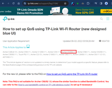

It's the 3rd time regarding your TP-Link router.
Did you turn off the QoS feature as suggested? And then turn on NAT Boost?
Yes, I did all that although there was no obvious dialog I found to to turn on NAT Boost. I also referenced the manual to disable the crap on the router (at least the things I had some understanding about) even though poor Tech Junky thought I ignored him in this regard. The bottom line is that I only deal with this stuff on an infrequent basis, I do not begin to have the ability to keep up with the obviously very smart and knowledgeable people like you guys/girls, and I have no other interest than to just get the thing working properly and then forget about it. I am sure there were things in the TP-Link device I did not understand sufficiently to even know to change but I did not have any desire, time, or ability to extend any additional effort screwing around with it. So, I simply bought a new router, the Netgear AXE7800/RAXE300, and, out of the box, without any heroics or a high level of knowledge as to be found on this forum, it worked perfectly. Even, surprisingly, the audio quality of cellular WiFi calling is now significantly improved. For my needs, the Netgear device is a true plug and play box with only minor inputs like SSIDs, etc. My starting post here simply asked why a switch integrated in a router does not perform exactly like a switch external to the router would perform and only referenced the TP-Link router but it is not the 3rd time regarding the TP-Link router (although I am not sure why that was offensive but I certainly apologize). I am sure the answer to this question about the integrated and external switches is obvious to many others here but it is not to me.
