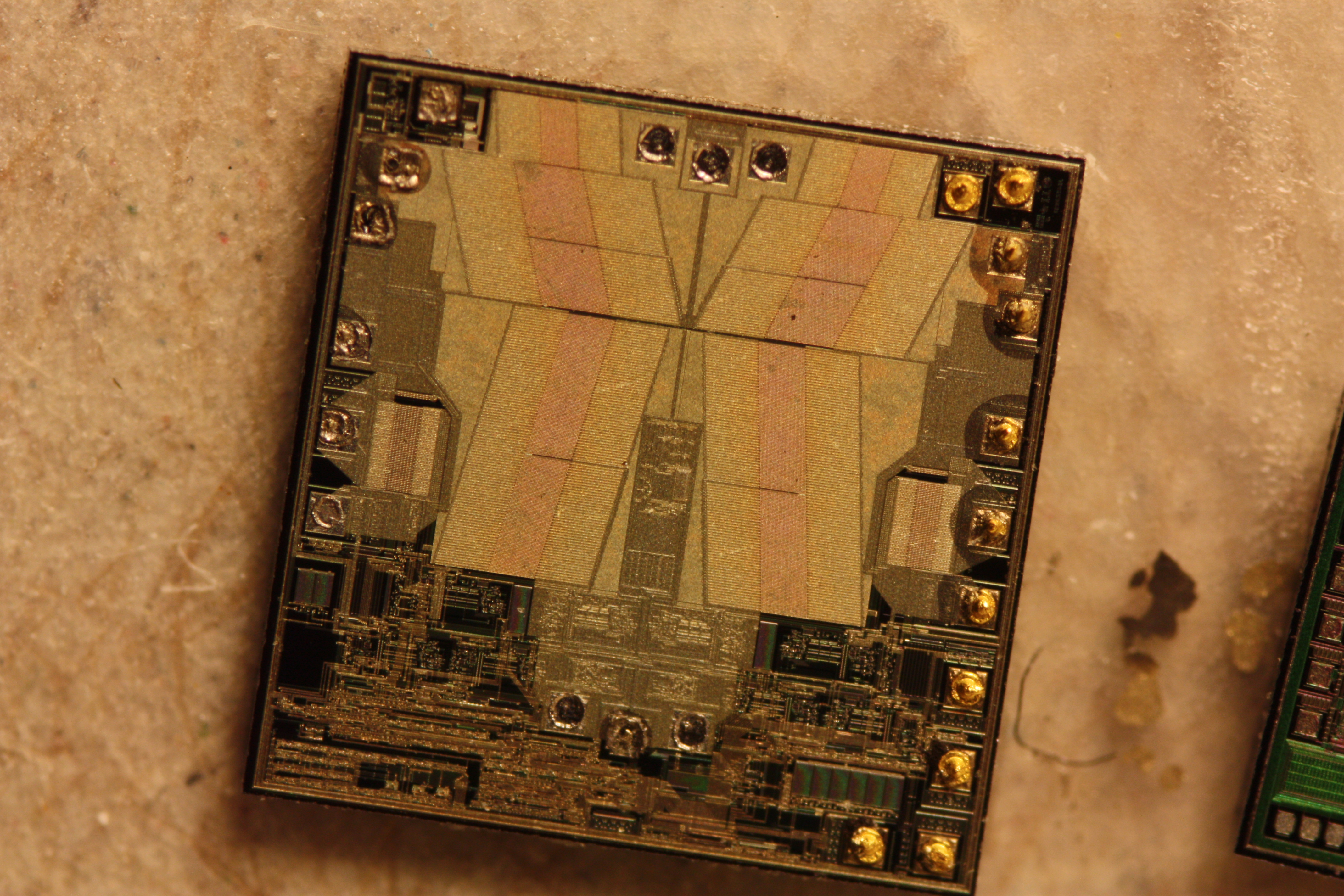

Why would a die look like this?
CTho9305
Jul 26, 2000
9,214
Why would a chip's die look like this? The system it came from (~1999 low-end laptop) had no wireless capabilities that I know of, so RF seems unlikely. I think the chip was made by Maxim.

2,689
Wild guess... If it's a Maxim chip, it might be for power management and those huge diamond sections are the integrated mosfets.

Originally posted by: firewolfsm
Are you sure it's a die? What component was it?
There was a chip on a laptop motherboard which I desoldered. I ripped apart the package and took this thing out. So, yes, I'm sure it's a die :). I didn't record the markings or the location on the motherboard. If I do this again, I'll keep track of everything so I know what each piece is.

475
Heh doing more home etching I see?
That would be my guess if it's power management. Maybe those are two PMOS and two NMOS fets for a full bridge + control logic? Got a microscope to see any markings?

1,663
I wonder if it had some sort of wireless capability. Those look like microstrip antennas with inset feeds.
