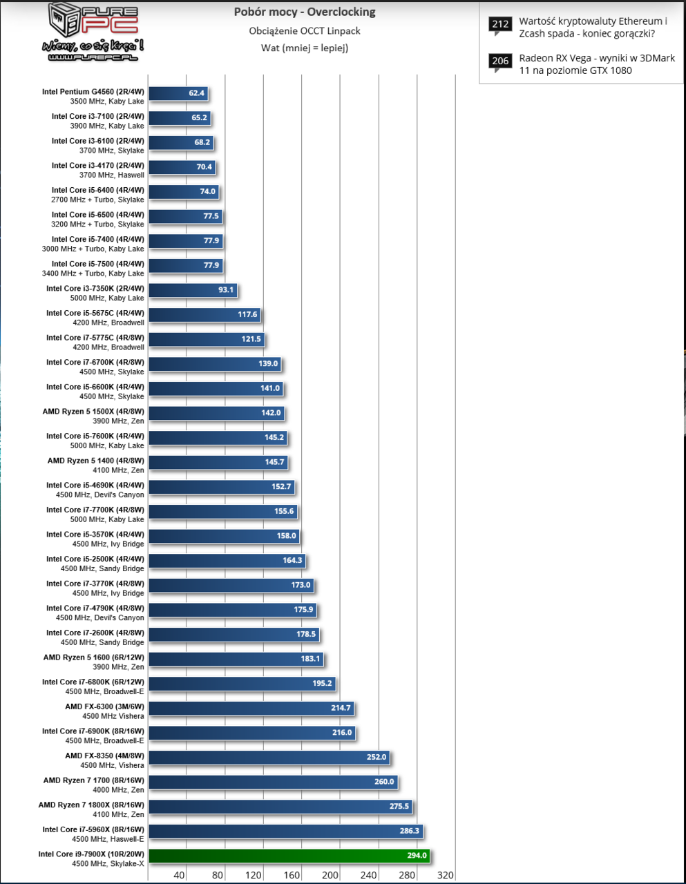

https://www.purepc.pl/procesory/test_procesora_intel_core_i97900x_skylakex_witaj_lga_2066?page=0,41
Ryzen 1800X is not as energy efficient as people think. It becomes very inefficient at high clocks too. On the chart you can see the power draw of various CPUs. At least according to that chart Ryzen at 4.1Ghz is less efficient per core than 7900X at 4.5Ghz when running OCCT Linpack. That would mean at same clocks Skylake-X should consume less power (and in the end produce also less heat) per core.
First of all, OCCT Linpack isn't a software you run to do actual things with. Secondly, every piece of silicon has it's sweetspot.
