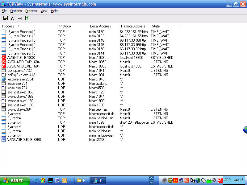

Download this free program (one Exe file no need to install, and one of many excellent programs by sysintrenals.com), http://www.sysinternals.com/Files/TcpView.zip
This is an example of the screen output, http://www.ezlan.net/network/tcpview.jpg
First column, tells you which process is using the Network.
Second Column, which protocol is generating the traffic.
Third Column, the local address. I.e. LAN Traffic.
Fourth column, External address (if any) I.e. to the Internet
Fifth column, current state of this process.
