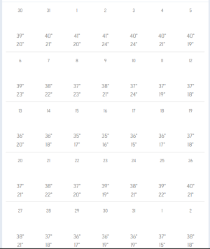

Almost sounds like a chunk of ice falling somewhere. Wonder if there's some kind of defrost cycle that runs. What's the outside temp while it's running? It might be too cool to run it and it's freezing up.
Thank you, I attached the weather.

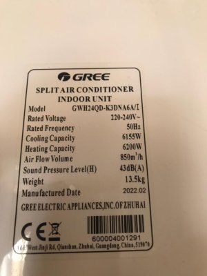

Thank you, Could you please how can I test the valve? The valve is an Electronic Expansion Valve.
I attached two photos.
