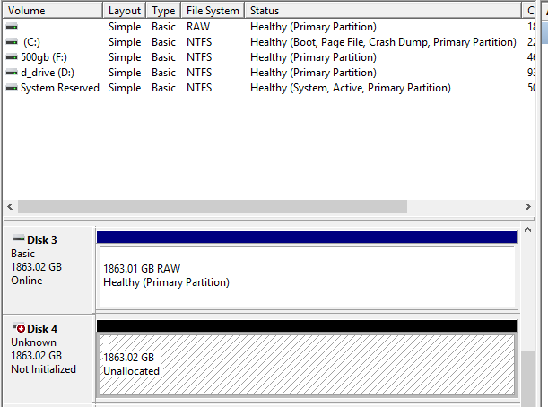

Bought a used 2TB Hitachi drive and noticed that it shows up as two drives. One drive is shown as a RAW partition. It can't be formatted and according to the properties has a capacity of 0 bytes. The other can be initialized and formatted fine. I can't make the RAW drive disappear. If I try to format it or use "clean all" in diskpart I get a "The device is not ready" message. Is there a way to format this drive so it will be recognized as one drive?
Where it says disk 4, right click on that and select initialize. It will prompt you to select mbr or gpt format, and after that you combine the two partitions to make one drive.
EASEUS Partition Master didn't make a difference because Windows 10 Pro Disk Management still detects the drive as being two drives. Starting with no partitions, EASEUS Partition Master can create a usable partition like Disk Management, but it doesn't show the second instance of the same drive. However, after using Partition Master, when I go back into Windows 10 Pro Disk Management it detects the same drive twice (Disk 3 and Disk 4) and always asks to initialize Disk 3. But if I try to initialize Disk 3 then Disk Management gives a "This device is not ready" error.

This drive is just connected over a standard SATA cable. Tried diskpart > clean all and it just gives a "device not ready" message on the RAW/0 byte drive. On the other drive it will finish successfully, but it doesn't get me any closer to having the drive being recognized as one drive instead of two.
Could it be auto-mounting a .VDI on the drive? Somethings really wierd, if it's detecting as TWO drives.
This drive was supposedly used in a data center. If this is some sort of virtual drive partitioning, exactly what steps would I have to take to undo that?
If you wipe the partition, does Disk Management? What motherboard is this? In the grand scheme of things, I don't see this hurting anything, but I would love it is we could figure out what's causing it.
Backup your data, unplug all other drives, and run a DBAN on it. If that doesnt fix it then its not a problem with the drive, most likely a windows issue.
+1
A used drive that may have nontypical metadata lingering on it. Something that Windows falsely identifies as something. The obvious solution is to not look at the drive via Windows. DBAN or live Linux distro looks at the drive differently.
