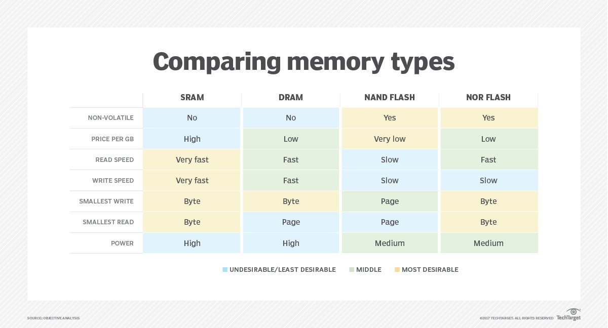

So this is something that has eluded me for a long time. Why do caches have more bandwidth than their capacity?
What's so hard about that? Of course the capacity is limited by die size. Cache(SRAM) is just not as dense as RAM or NAND memory, but It is much faster.
64MB V-cache using 7nm process is 41mm2.
Just for 1024MB of V-cache you would need a 656mm2 7nm chip. That's just too expensive and not really worth It.

  1. CPUs compute at a very high rate, and ideally all the data they need is instantly available (so in the same cycle).
  2. But holding and delivering data at that rate is very costly, both power usage and area wise.
  3. So such data storage at essentially zero latency is kept at a minimum size.
  4. That's why you have "tiny" level one (or zero) cache that has excellent latency and bandwidth.
  5. At the opposite end you want to actually permanently store data. There bandwidth is the lowest and latency is the highest, but the advantage is storing a lot of data is cheap.
  6. All the different caching levels in between those two extremes are further compromises included to lift different bottlenecks.
