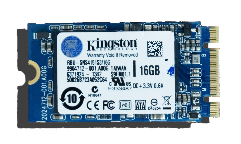

P.S. Apparently some of the newer Chromebooks like the Acer C720 are also coming with small 16GB and 32GB SSDs in M.2 form factor as well:
http://www.thessdreview.com/daily-n...-2-ngff-128gb-sc2-ssd-worlds-easiest-upgrade/
16GB Kingston SATA 3 M.2 (NGFF) SSD and it is 42mm in length, better known as 2242.

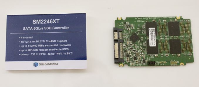

http://www.anandtech.com/show/9357/...ys-upcoming-sm2260-pcie-30-x4-nvme-controller
Another product Silicon Motion had on display was the SM2246XT, which is a DRAM-less version of the popular SM2246EN. There is a slight performance impact from the lack of DRAM cache as only parts of the NAND mapping table can be stored in the controller's internal SRAM cache, but in return the SM2246XT offers lower cost due to a smaller die (no need for DRAM controller). Obviously the drive requires no separate DRAM either, which further reduces the cost for the assembler of the drive. SM2246XT is already used by SanDisk in the SSD PLUS and Z400s that was released a couple of weeks ago. I believe we will see the low-end market shift more towards DRAM-less designs in the next year as the race to the bottom gets tougher and with more sophisticated controllers it's possible to have decent performance even without the DRAM cache. Currently Silicon Motion has no plans for an XT version of the SM2256, although I would personally see TLC NAND and DRAM-less controller as the ultimate value play.
Looking forward to seeing improvement in the area of DRAM-less SSD controllers as I remember seeing mixed reviews on SSDs which use the DRAM-less Phison S9 controller.
