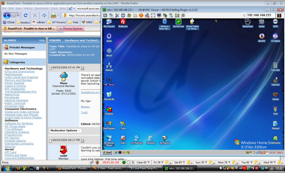

1. UltraVNC server running as a service encrypted and using a port up in the spectrum like 62222.
When some thing extra is needed it can be easily accessed by VNC.
Example.

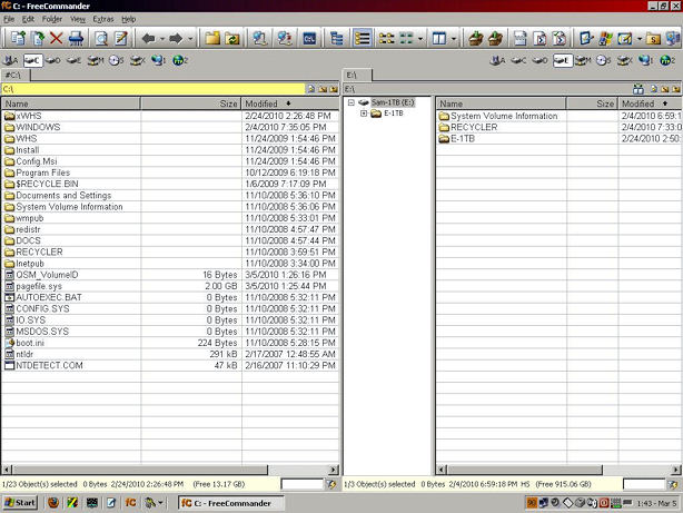

2. Free Commander is a Win Explorer type that can read each drive on its own and provide a view beyond \\WHS\
Example.

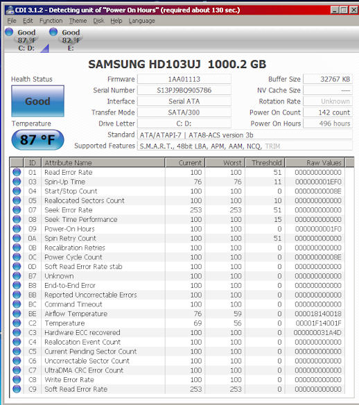

3. Disk info, runs and show separately each HD, its make, capacity, etc., and does basic Hardware evaluation as well.
Example.
