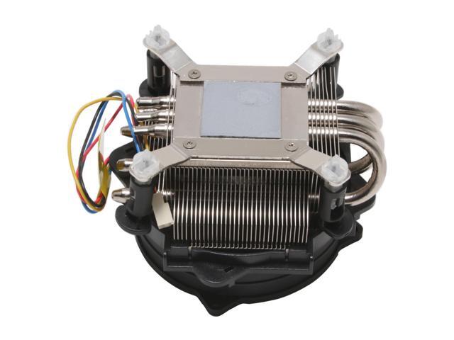

Whoopsie... Is this going to be a problem?
I ordered some parts for a new PC.
I got a Cooler Master and I took it out of the box and its been sitting on a table for a while.
Unfortunately, someone did some cleaning and put the exposed bottom of the cooler on some velcro, and scratched up the contact pad quite a bit. The pad is suprisingly sensitive.
I plan on over clocking, so I am going to spread some Artic Silver 5 on there. Will this cover the defects in that pad that were caused by scratches. If it will cause a problem, is it possible to replace the pad with another one? If so, where can I get one

Is that thermal tape hunked on the bottom there? ack. I'd return it and order a different one.

If you messed up that thermal pad, it's fine, as you said you are going to use Aritc Silver 5 anyway. You don't want to use both--just one or the other. So get something to clean that stuff off properly (90% or better alchohol, etc), and it'll be fine.
Judging by the newegg reviews, at least one person has successfully used it with the thermal tape/pad removed and AS instead.
It looked to me like there was an indentation on the bottom which might have prevented you from using it without the pad. Apparently, that is not true, so as FMC said - just clean that gunk off and use AS5 instead.

Oh yeah, that shouldn't be a problem at all. Especially if you're going to use thermal paste.
