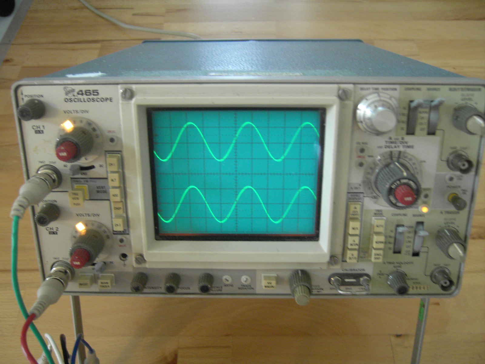

I love the 465 scope, one of the best tektronix ever made. I use a BK precision scope a lot of the time as well. Both are analog but I don't use scopes for digital work, for that I use logic analyzers.

Now, since your price range IS limited, you have a few options. If you really do not NEED screen shots, I happen to really like the old Tektronix analog scopes. Other have mentioned the Tek 465. If you can find one in great shape in your price range, that might be an option. The layout of the buttons and knobs is confusing at first, but completely awesome once you get used to it. Also, analog scopes have an awesome update rate (see below). If I only had $400 or so, I would probably rather have a nice analog scope over a cut-rate digital one.
** BEGIN EDIT **
I really DO love the Tek 465. Unlike analog scopes, everything you need is on a knob or button right at your fingertips. No menus, trying to remember which menu has the option you are looking for, etc. Once you get use to it, you can play that thing like a violin. They really are a pleasure to use, given the limitations of being an analog scope, and being old and having limited bandwidth.
