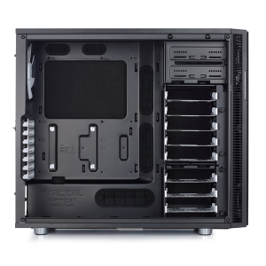

My Fractal R5 has a hard drive cage that's removable.. but I'm running 5 hard drives.. I'm not sure how I feel about leaving some of them on the floor of the case or maybe I'll have to DIY hack it.

I mean I use a fractal Define R5 case..
So I have the ability to at least remove the upper hard drive cage if needs be for video cards.. however I'm running 2 NVME and 5 SATA HDD's. Those would be on the floor area then..
Do you think it's worth doing that for a longer card or just get a shorter card and leave the hdd's in place?

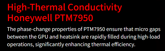

Get the Reaper. It has the PTM7950 thermal pad which will ensure that you never have to worry about repasting your GPU.

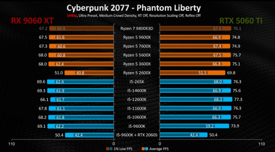

A small update:
Apparently the 12600k isn't really bottlenecking the 9060xt which is good to know but 5-6 year CPU's are..
I think that chart would look very different once RT is turned on.
And increasing crowd density will further separate the boys from the men.
Exactly. I don't know why those crazy Canucks tested that way, but it is a poor methodology for CPU testing. Phantom liberty has some CPU heavy sections. Daniel Owens shows a 5600x getting crushed, no way a 3600X is going to hold up. And why would I play on ultra but turn down crowds and traffic? Open world games feel more alive and immersive when those settings maxed.
I play mid crowds but I was very choppy with RT on and it only seemed like some of the lights in clubs were different.
I always play with shadows off.. since Shadows murder any and all video cards.. fps/ mmo or anything. But the drop from 144 to 35 with RT OFF to ON was too much for me.
With RT off I am hitting 144 even in ultra.
BTW I'm not impressed with FSR 3.1 frame gen or whatever it is.. not doing enough to counteract the RT hit.
CP2077 is an Nvidia friendly game anyway. There are plenty of other games (check in TPU review) that don't murder RT performance so badly on Radeon cards. AMD even proposed a better hybrid RT approach to only light objects that matter to the scene but no, developers high on free Nvidia hardware don't care.
