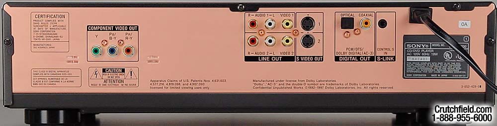

Look here guys! : Connectors
It's pretty self-explanatory:
[*]The black connectors where it says &quot;S-Video out&quot; is for S-Video
[*]The three green, blue and red connectors where it says &quot;Component Video out&quot; is for Component Video
[*]The yellow where it says &quot;Video 1&quot; is for Composite video.
The picture quality (worst->best): Composite -> S-video -> Component Video
