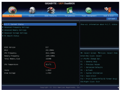

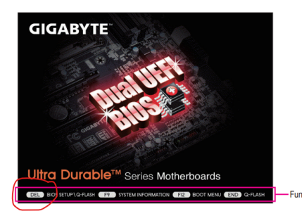

It acts like that! Somewhere I once monitored a temp reading. Where is it now?
One of the easiest ways to check temperature is in bios. If it steadily rises and PC shuts down (at about 70c), then problem is found 😁
Press <DEL> at startup screen
CPU Temp should be in MIT status page:
