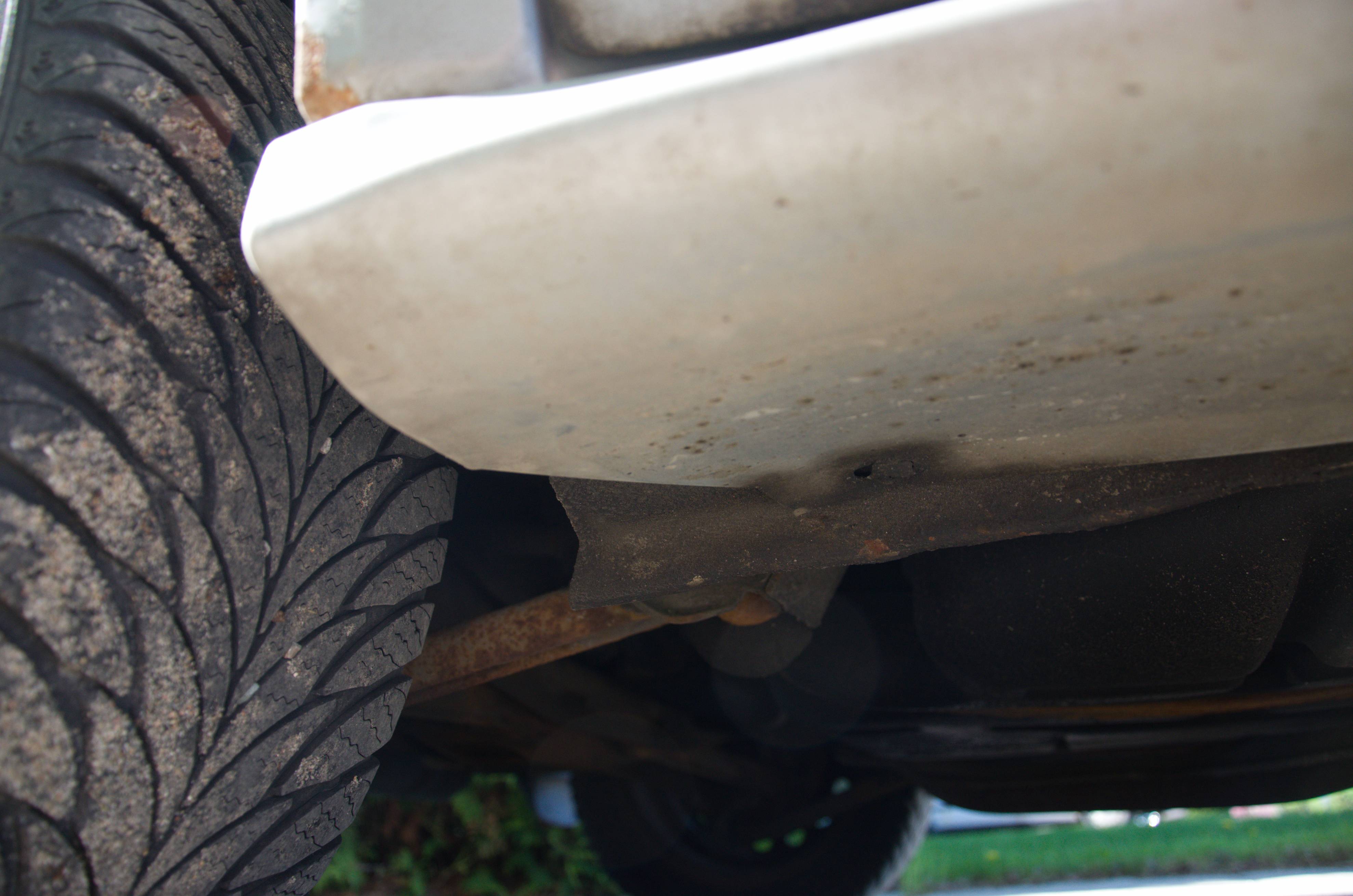

I don't see any kind of arrows, it's pretty much just a flat panel that runs all along the car, I'm guessing that is cosmetic and not actually structural. Hard to get a pic since the car is pretty low, but here's how it looks:
(That's the rear)

How does the owner's manual indicate to place the jack to change the tire.
Unless you are rotating tires; one tire off at a time should suffice.

It does mention a notch but I think it's mostly rusted out so there's a bit of guess work. I'll check more carefully for it. I guess I can just put the stand right next to the jack? That whole general area where the notches are should be structural right?

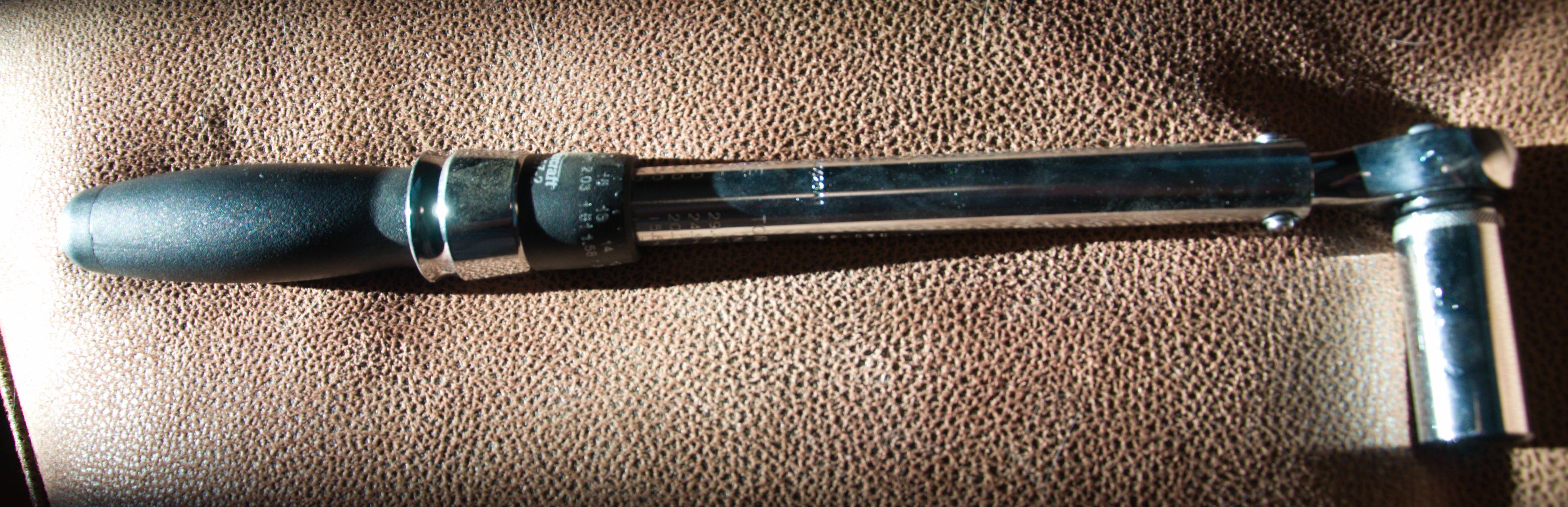

Only thing, how is a torque wrench suppose to work? I thought you set it to say, 100lbs and it would click when you get there, but mine does not do that so I'm not sure how to tell when it's torqued enough. I just put it tight enough without over forcing, but really, I don't want to drive around too much till I know for sure I torqued it properly. This is my wrench:
It's a Mastercraft, did not come with any instructions. I figured out how to adjust it, so I put it on the lowest setting just to test it but it does not do anything. I highly doubt I need to force the nuts tighter than what I did. I probably even overtightened them by trying to see if it will click or something.

It should make a click and give slightly when you reach the torque value.
Is that a 3/8" or 1/2" torque wrench? I think the mastercraft 3/8" one uses inch pounds and is useless for tires.

It's 3/8ths and yeah it uses inch pounds. Manual says to torque to 100 lb/feet so yeah guess that wont work. Just realized that now. I'll have to try to see if I can return it tomorrow. In fact even that jack I am not too happy with, I will need to look at a better one that is shorter but can go higher, probably want a floor jack I'm guessing. Then I can slide it right under the centre of the car and jack the whole front or back end, and then add the two supports and do two tires at once.

I made the same mistake with the torque wrench. It's deceiving cuz the mastercract wrench is the same size as my other 1/2" 20-150 ft lb torque wrench.

Is it true you're not suppose to use the torque wrench for loosening the nuts? I read that somewhere. I find it's easier to just use that than to buy a separate tool.

Torque wrench is only for tightening. You might damage the wrench or mess up the calibration if you use it to loosen. Especially if it's a cheepie torque wrench
I use a breaker bar from harbor freight to loosen. Pound with rubber mallet if really tight

Got it working, bought the proper torque wrench that's in lbs/feet so I was able to properly torque and hear the click. Also bought a low profile floor jack, did not try it yet but it already looks like it will work way better. I'll have to test it out to be sure. Just have to drive a bit more now then I'll retorque.
