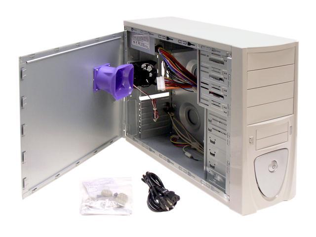

Different looking product, but yeah, it's the same idea. This actually looks like it might be better since it's completely sealed. Thanks.
Can anyone think of a reason why we shouldn't all be using one of these?!

you can choose either one, blowing cold air in or sucking hot air out. but most likely blowing cold air would be a better choice. just keep in mind the every system is different, so you may want to try both configurations and see what works best for you.

yes that is right. but what im trying to say is,with this kit you will have the option of blowing outside air (cooler temps) directly into the HSF.🙂
Yep, i've got sheathes oone of those green on my Dell, and it works very well, the only problem is that it doesnt give much airflow to the rest of the system, I remember my old pentium II made by Dell, it had a 92mm fan in the rear, with no sheathe, that was right next to the processor, since it was open it sucked air from the entire system, and let me tell you that thing pushed some HOT HOT HOT air out! 🙂
I think that bringing cool outside air directly to the HS will cool both the CPU and all the air inside the case some. The better way. Some that have used that duct kit have mounted another fan at the outer end of the duct - they say it helps. My case has two 80mm fan mounts at the rear and I intend to use one of them for a duct kit in the not too distant future.
If you use the duct to bring cool air to your HS, make sure and add some kind of filter on it. Dust collecting on your HS will do it no good.
ducts can cut airflow from the fans, so its not totally free bonus cooling. the hot air still goes into your case. most people try to cool the entire case so they can make sure all components are nice and cool. uber cooling your cpu has no point really unless your trying to overclock
