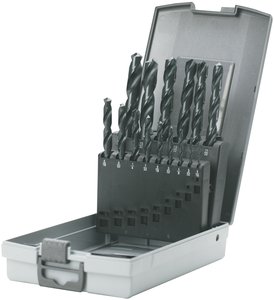

A cobalt bit set - way overkill! Your grandchildren's grandchildren will be handing then down to their children. And you will never be drilling through something so hard that you will need a cobalt bit. HSS (high speed steel) bits will drill through wood, aluminum, brass, plastic, etc..
This ($53) would be more than adequate:
Or this: ($27)
eBay: ($24)

The issue is that the sub $100 sets break all the time. I want something that will last forever. I mostly just drill into wood, sometimes metal. Most hardware store brand sets will break if you drill into even a knot.
Or this: ($27)
eBay: ($24)
I've used some of the Ryobi kit, the steel just isn't up to snuff, they break and get dull pretty quick.

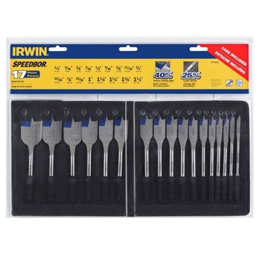

Get a set of brad and spur bits for soft wood or hardwood (or a set of both) for drilling smaller holes. Get forstner and auger bits too if you want to spend all $500. Then get a set for metal too.
There are bunches of companies still making this stuff in the US, in any length and configuration imaginable. I liked using WL Fuller when I was butchering wood for a living.
