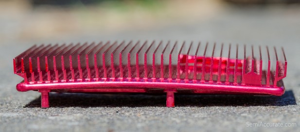

When Vapor Chambers Fail
NTMBK
Nov 14, 2011
10,518
6,027
Yeah, I don't think your heatsink is meant to look like that :eek:
http://semiaccurate.com/2016/05/04/when-vapor-chambers-fail/
EDIT: The linked Dell page has some even better ones:

What is a "failure" of a vapor chamber? I thought it would be a breach of the chamber. If that happened, the chamber would not be able to swell up like this.
In fact, I would guess that you need the vapor chamber to remain intact to be able to build pressure like this to inflate like a metal balloon.
And to build pressure like that, you would need extra heat to boil all the liquid in the vapor chamber, to where the vapor pressure could rise so high.
So could someone clarify? Is it possible there was a failure in the video card, that resulted in short circuit extra high heat output, that would naturally and expectedly cause over pressure in the properly functioning vapor chamber?
More likely a case of quality fade. Chinese factory cuts and cuts to save in components or materials. Product fails at some-point down the line but the factory is long gone or says oops so sorry but what are you going to do about it? Use the other Chinese factory doing the exact same thing?

Same card for sale here. My guess is that Dell (or AMD?) got those coolers from xyz supplier, lowest cost passive cooler made in China. Looks like the fluid inside might be breaking down into gases that creates enough pressure to bend the aluminum, just a guess.

Pfft, just another one of those "issues" that get blown out of their proportions. The card is clearly vapour ware and lacks the right steam quality.

Looks like a combination of faulty design, and picking a bottom rung manufacturer.
The stress on the card looks pretty substantial, I wonder if there are any cases of that just exploding off?

Saw few of those at work a while back.
Lets just say that it did affect overall performance and ability to output picture.
