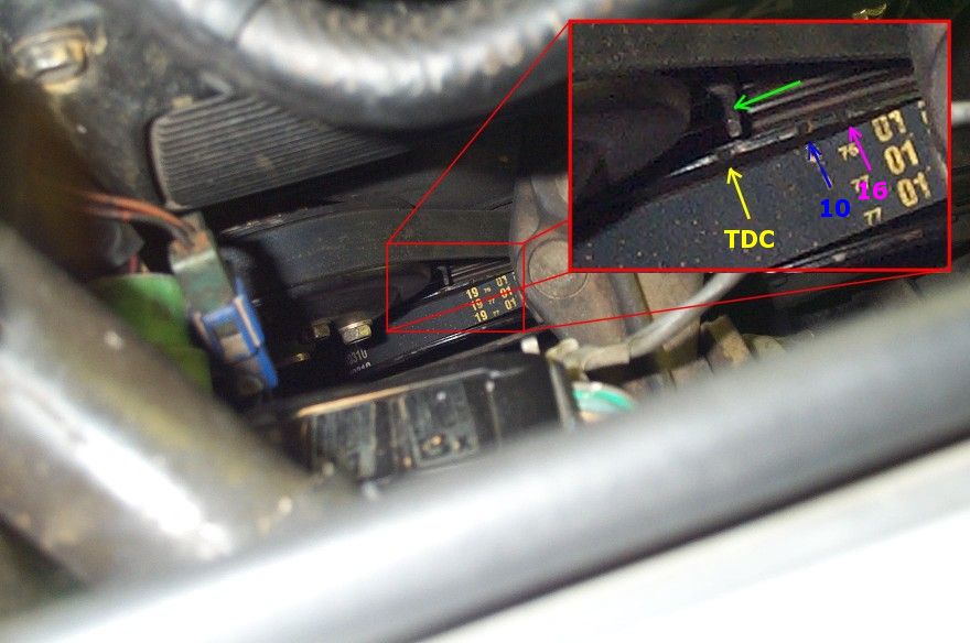

Im a fool though, I should have done a little more research before bothering you guys, cuz this guy covers it thoroughly in his blog...
Image and quote courtesy of padandwheels.com
The green arrow is pointing to the timing pointer. That is going to be your reference point. You need to find this before you are able to do any kind of adjustment. (You may want to find this first with a regular flashlight, if you aren't sure where it is located.) The 3 notches on the crank pulley, that the different colored arrows are pointing to, are indicators telling you where TDC (top dead center, yellow), 10 degrees advanced (blue), and 16 degrees advanced (purple).
TADA!
