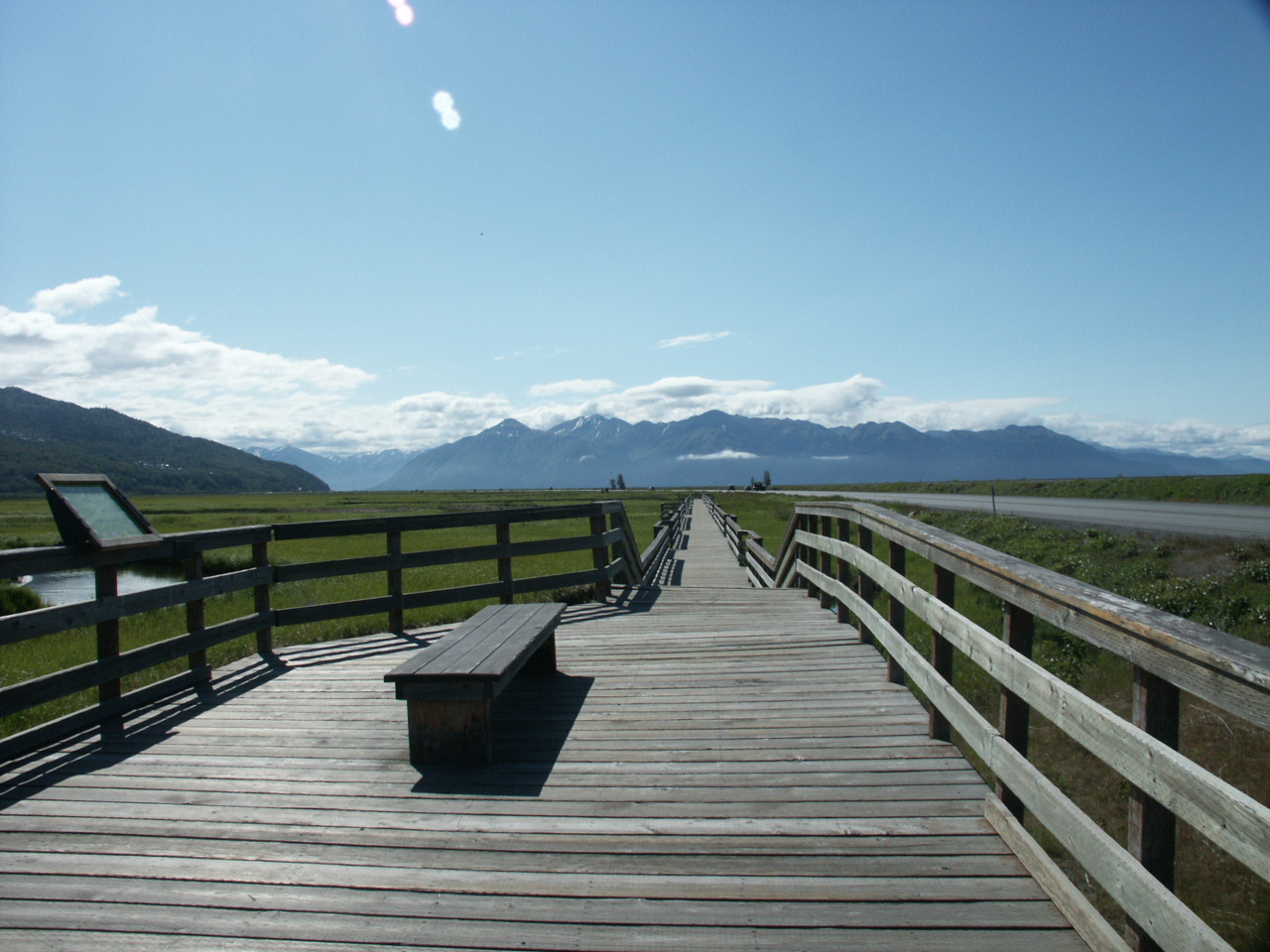

I'm still trying to figure out why people insist on "treating" treated lumber. Looking for ways to keep busy, or what? 😕
I leave it to weather naturally. Turns a nice silver, which is fine with me. No muss, no fuss, and it's still warranted for 30+ years.
