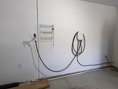

FWIW two years ago I hardwired my Emporia using 6/3 Romex on a 60A circuit and it has been plenty for my needs. I even derated it to 32A because that was more than enough for my weekly commutes.
Here is a pic of the Emporia EVSE after I did the installation.

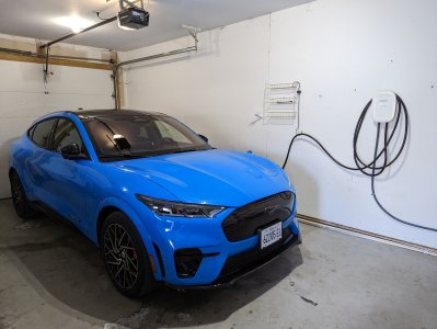

And here it is charging the Mustang for the first time.
