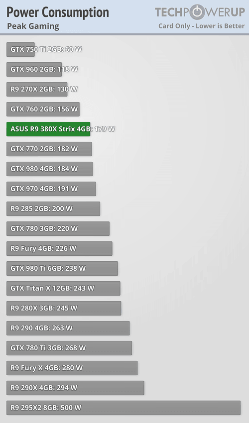

There's nothing NV sells at $100 that's worthwhile "upgrade" for you, it will be downgrades in performance.
This is how it looks at 1080p:
Note the 750Ti is just so gimped you can forget about that.
Power usage, IIRC the 6970 (your card right?) used ~150W in gaming.

Correct sir, HD6790 and she likes her juice which is a primary reason for looking into an upgrade.
